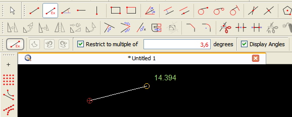

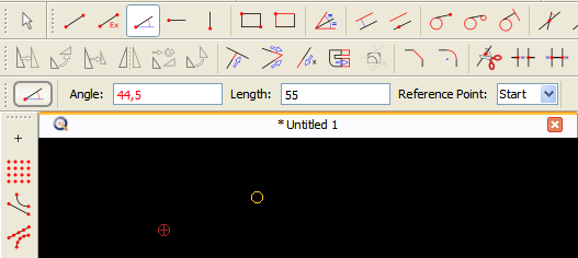

Question: If I use the wrong decimal point character it will show me the wrong value in red - but the tool is still, in limits, usable.
If I compare this with the "Line from Angle LA" tool it will warn me with the value in red and block the tool completely.
I think that makes sense - is it possible to have the same behavior in your tool?
