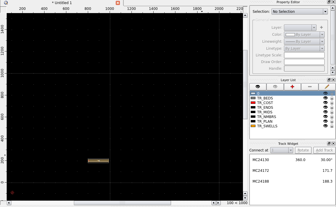

Finally... :D Thanks to Andrew and his perfect support, a first version of a TrackWidget is implemented. :D
Attached there is the current version. Consecutive Exectution is removed - TrackWidget replaces it with the benefit of a better user interface and better integration into QCad. You'll need at least QCad 3.7.2 because I'm using setGroupOrder, or you have to remove the call in each script (just search for "action.setGroupSortOrder(QCTrack.MenuOrder.GroupSortOrder);" and remove the entire line).
The track widget integrates itself into the Widget panel. Now just select the desired track from the track widget and start extension of an existing track by typing QN or selecting "Insert new track from track widget". Mouse over the existing track and you'll get a preview of the track that would be inserted by left mouse click. If you want to change the connection end, you may right-click in the track widget, click on the "rotate button", select "Rotate track at track widget" or - most preferrable - just enter QR (will work even with mouse over a track, so you see the result "on line"). I will post an updated tutorial later.

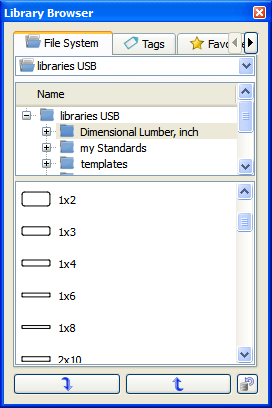

Question: I tried the function "Select ... duplicate and move". The tool is asking for "Select end of track" but after picking the end of a track .... nothing happens. I'm doing something wrong? It was working in a predecessor version.
And now I'm sure ...... you will kill me 8) :
Have you noticed the nice preview Icons in the QCAD Library Browser? Is that something what could be implemented in this new TrackWidget?
However - I never checked before similar Programs/Scrips etc. in the www but now I can already tell that your script is VERY good! Thank you for share this with us!
Uh, I have to check this out soon. "It should not be different than before". :oops:
Hehe, no, I won't kill anyone for a proposal I already started implementation of. :) In the version 63 there is a function that should generate a preview icon, but I couldn't finish it today (debugger always tells me: "can not add null widget"). So: not ready, but hopefully sometimes it will be. :)

In the new version, Consecutive Extension is removed. Instead of that there is a Track Widget that can be enabled / disabled via menu item QCTrack / View track widget or QV. You then get something like the Block list but with some more information about the tracks you may add.
Track widget enabled
To extend your an existing track, just select a track from the track widget and click "Add track" or choose menu item QCTrack / Insert new track from track widget or type QN. With mouse over the existing track, there should be preview of the track that would be inserted on left mouse click. Edit: starting with version 83, "insert new track" with shortcut QN inserts a new track "everywhere", and "connect new track" with shortcut QC inserts a new track that is connected to an already existing one.
Add track
Even during preview, you may type QR or select QCTrack / Rotate track at track widget (or you may right click inside the track widget or select a track end from the combobox or hit the Rotate button at the track widget) to select another track end to connect.
So with just 12 clicks you may insert 12 tracks - compared to Consecutive Extension, you save the double clicks :wink: and can move/zoom during insertion and you get a preview - I hope, no one is missing the "old" variant. :wink:
