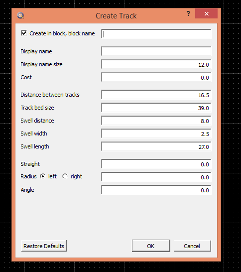

Yes we are talking about the same thing here, I hit the Create and no dialog appears!

No other plugins installed.smf wrote: Do you have any other plugins / addons installed?
I've re - read your posts several times, re - installed QCTrack several times - still same result, no dialog window appears.
Maybe this is an issue with Windows 8 ?

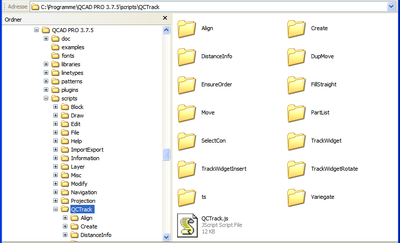

I had the same problem when I first unpacked the downloaded archive. I then renamed the unpacked folder from "QCTrack_V**" (same name as the archive) to simple "QCTrack" and after that the dialog appeared. Maybe you have the same problem...

smf: the folder name might very well be the problem.
I'd generally recommend to create a ZIP file which contains the folder 'VCTrack' at the top level instead of only the sub folders and files. This also has the advantage that the user will get one clean folder after extracting and not a whole number of directories which need to be moved around.

"Create" works on Win XP ...
If somebody needs to doublecheck the folder structure - this one works for me

Thank you very much for your input, it was indeed the folder problem.
smf , Husky
The 'Create Track' dialog window is opening properly now, thanks very much
Now full steam ahead - choo choo
