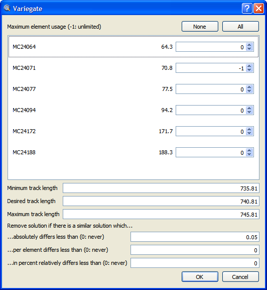

I used your Spielplan.dxf for testing and one of my experience is this: Two single straight tracks (MC24172) in my drawing, not connected (distance ~740.81...), Tool "Fill with straight tracks" and this settings ...
... will crash QCAD Pro on my XP. Maybe I did something wrong but on the other hand it should not crash QCAD. Any Idea on this?
Secondly: Not "extremely" important but nice to have for all upcoming user would be a sort of Version Info. What do you think?

Hi Husky,
thanks for the report, I can reproduce this: QCad is crashing under XUbuntu 14.04, too. I think this has something to do with "no result" and "ok clicking" - if there is no solution, a message should appear or at least the ok-button should be disabled. I will insert this in the next version. And yes, some kind of "version info" would be nice, but, hm, in a separate menu item "QCTrack version"?
