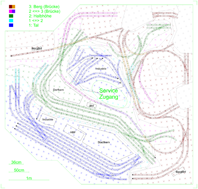

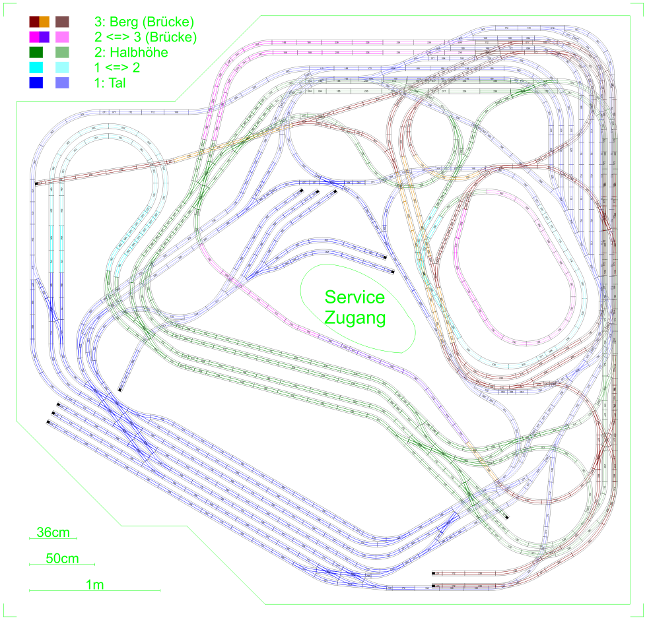

The last time I played a bit with QCTrack (and of course found several todo's). Attached is another example. :) Thank you, QCad! :)
The complete track plan:
track plan
Only visible track parts and landscape hints:
visible parts
