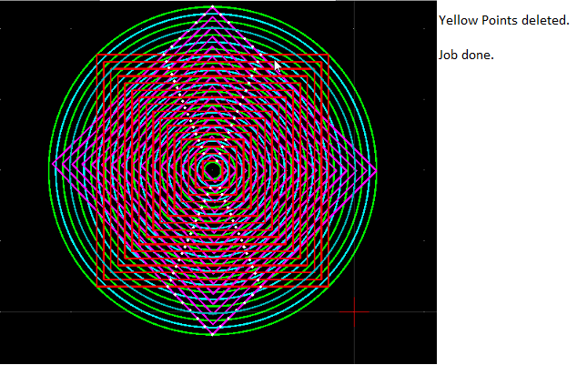

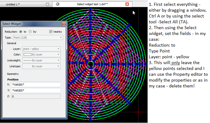

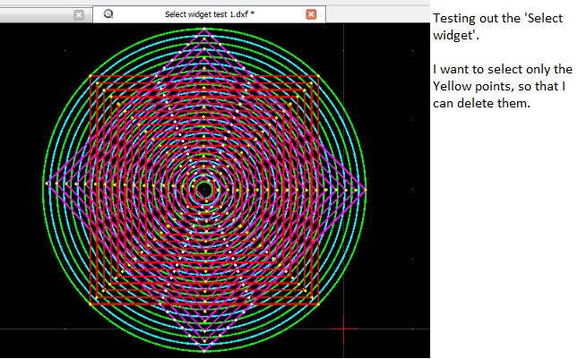

I was so impressed by this little 'Select widget' submitted by smf I just had to highlight it (hope you don`t mind Stefan).
Very often I need to select only one type of entity and modify them and this widget has been so very useful :wink:
To try out smf`s widget please download the zip file and copy/paste all files in qcad/scripts/MyTools/SelectWidget where "qcad/scripts" are the original folders and "MyTools" is an arbitrary name, "SelectWidget" is fixed.
Select widget test 1.png (90.2 KiB) Viewed 19255 times
Select widget test 2.png (117.59 KiB) Viewed 19255 times
Select widget test 3.png (87.15 KiB) Viewed 19255 times
