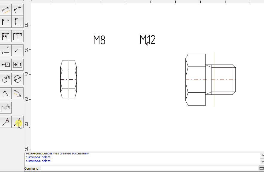

I've a new script written. Text-aligned leader. I'll be glad if it is useful to someone.

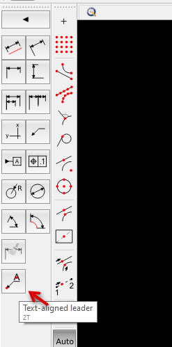

Ok, what I learned now is that there is a tool In Menu called "Leader from Selected Text" (T2L) but that tool is not in the Tool Bar ...
... and a tool In the Tool Bar called "Text-aligned Ieader (2T) which does't exist in the Menu, correct?

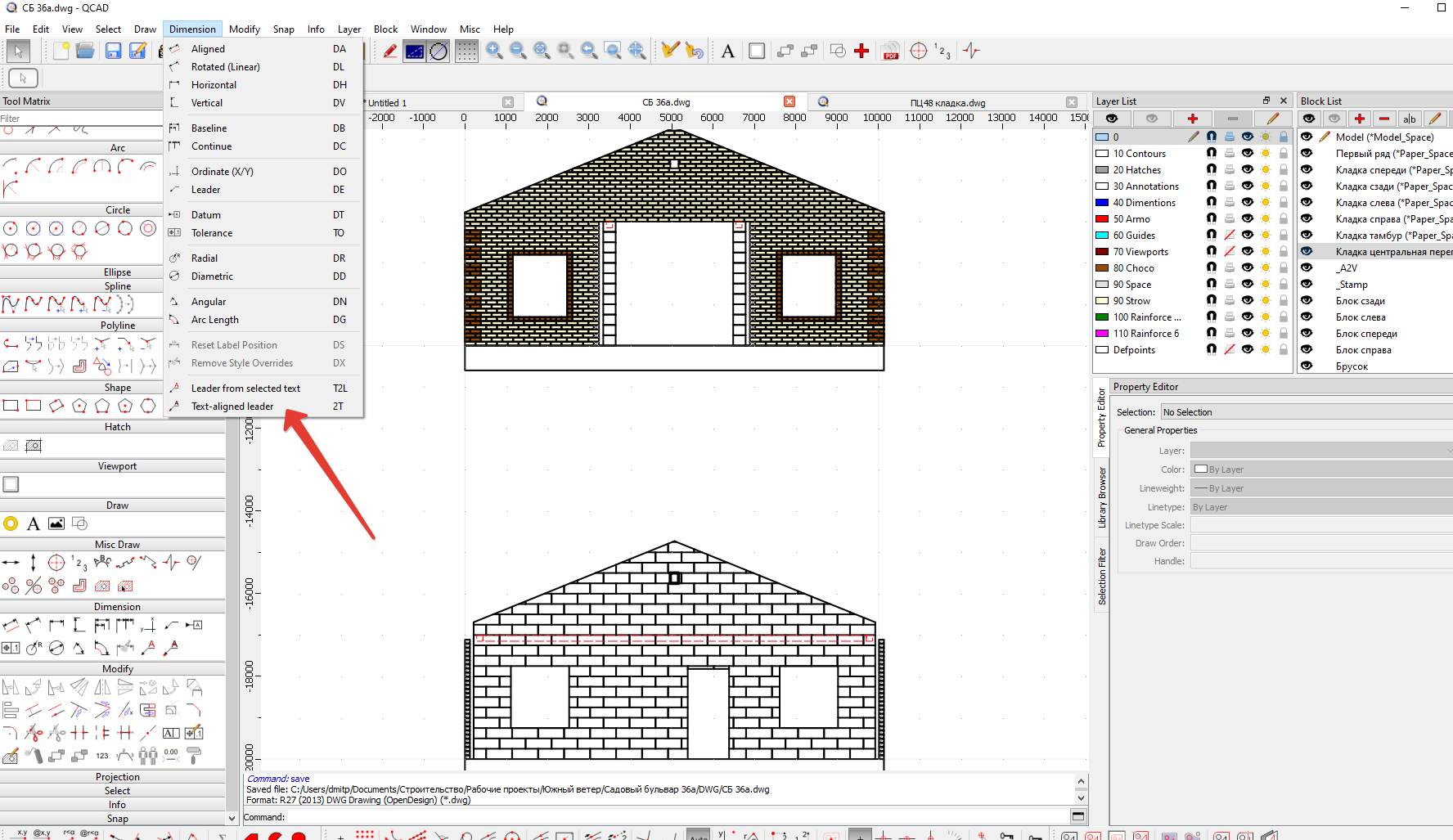

This is what I get out of your script:

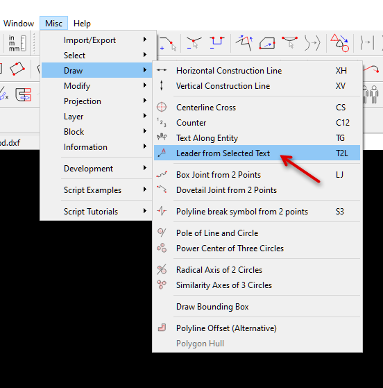

Ok, I played around with a fresh QCAD installation. The thing is: T2L is already part of the last QCAD release. Located below misc - not existent in any other menu.
If I put your script below misc the result is what you see in my screenshots and I'm sure you are not less confused by the result!

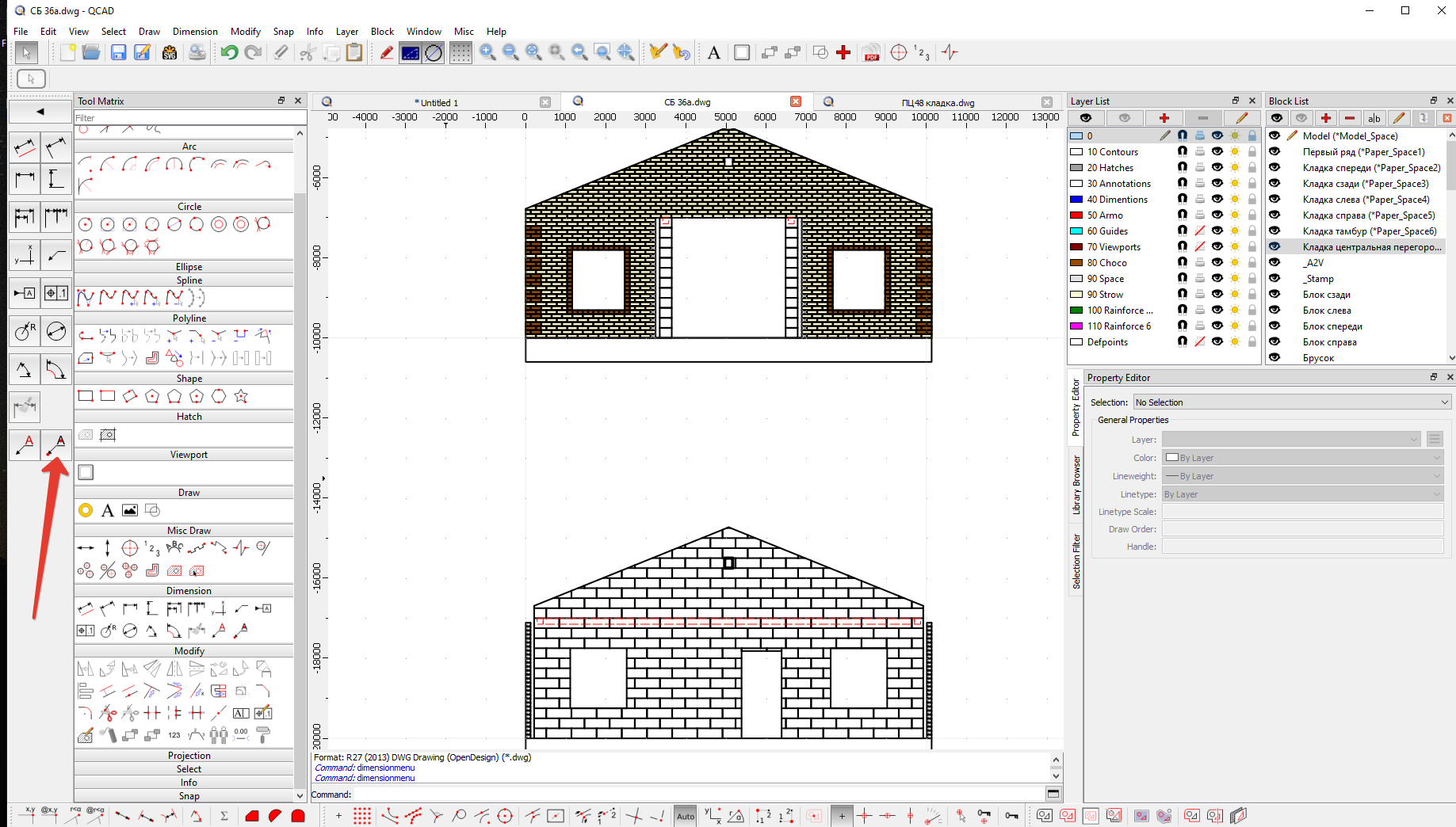

OK! The icons have been found. Does the script work like in an animated gif?

Refer to viewtopic.php?f=107&t=8925&start=15#p35554
Only users that have both the scripts sets installed custom will see both buttons like you intended.
The script sets under 'scripts' supersede those that come with a QCAD release.
It requires a round trip to get everything right.
It gets even weirder when we rename or move a script around in the script structure.
And then I refer to 2D Centroids. :wink: :lol: :lol:
PS: Andrew has just adopted 2T as a replacement for T2L ... under "MiscDrawMenu"
