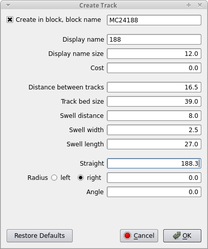

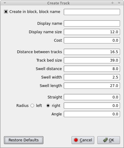

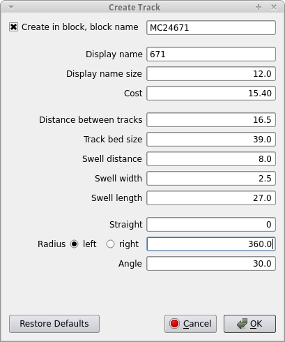

To create a new track part, select "Create" from the QCTrack menu. The following dialog will appear:
  • Enter a block name for the to be created block, e.g. "MC24188" for a Maerklin C-System track with number 24188.
  • Because the "MC24" is all the same for all compatible tracks, this information isn't needed on the final plan, so just enter "188" at "Display name".
  • Next, you must enter either a length at "Straight" for a straight track, which would be 188.3 for the MC24188, or you must enter "Radius" and "Angle" for a curved track.
  • You may also enter the cost of a single peace of MC24188 at "Cost".
  • All other values are default values for H0 (scale 1:87) systems, usually they are all the same for one type of track parts.
Clicking "OK", the script will create a new (standard QCad) block with the name given at "block name". This block will have:
  • The ends of the track, they are very imported for all other features of QCTrack. This "ends" are two lines on TR_ENDS layer. Usually there are 2 for normal tracks, but you may edit the block later on to have 3 for turn outs, 1 for track ends. This will be discussed in a later step.
  • The main layout on TR_PLAN. Those lines have the color of the layer you put the block into, so you can have the same track elements on different layers and the lines of TR_PLAN will have the color of the corresponding layer and will therefore be distinguishable from eachother (see Spielbahn example above).
  • A line on TR_MIDS. This is for those of you in need of a very simple overview plan and is used to calculate track and/or element lengths.
  • The bounding box contours of this element on TR_BEDS.
  • The entered value at "Display name" will be inserted in the block at layer TR_NMBRS.
  • From several to many :wink: swells are created on TR_SWELLS. Those are just for "reality" reasons and have no special function.

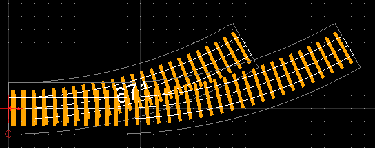

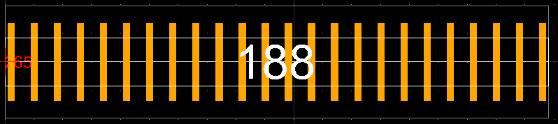

If you create a curved track, you don't need to create one for "left curve" and one for "right curve", if your elements have symmetric connectors (as is usual).
So, for example, you could create a straight curve with 188.3mm length, name the block MC24188 and have 188 be displayed in the plan, calculating cost of 2.65-something with the following input:
Therefore, you'll get a new QCad block looking like that:

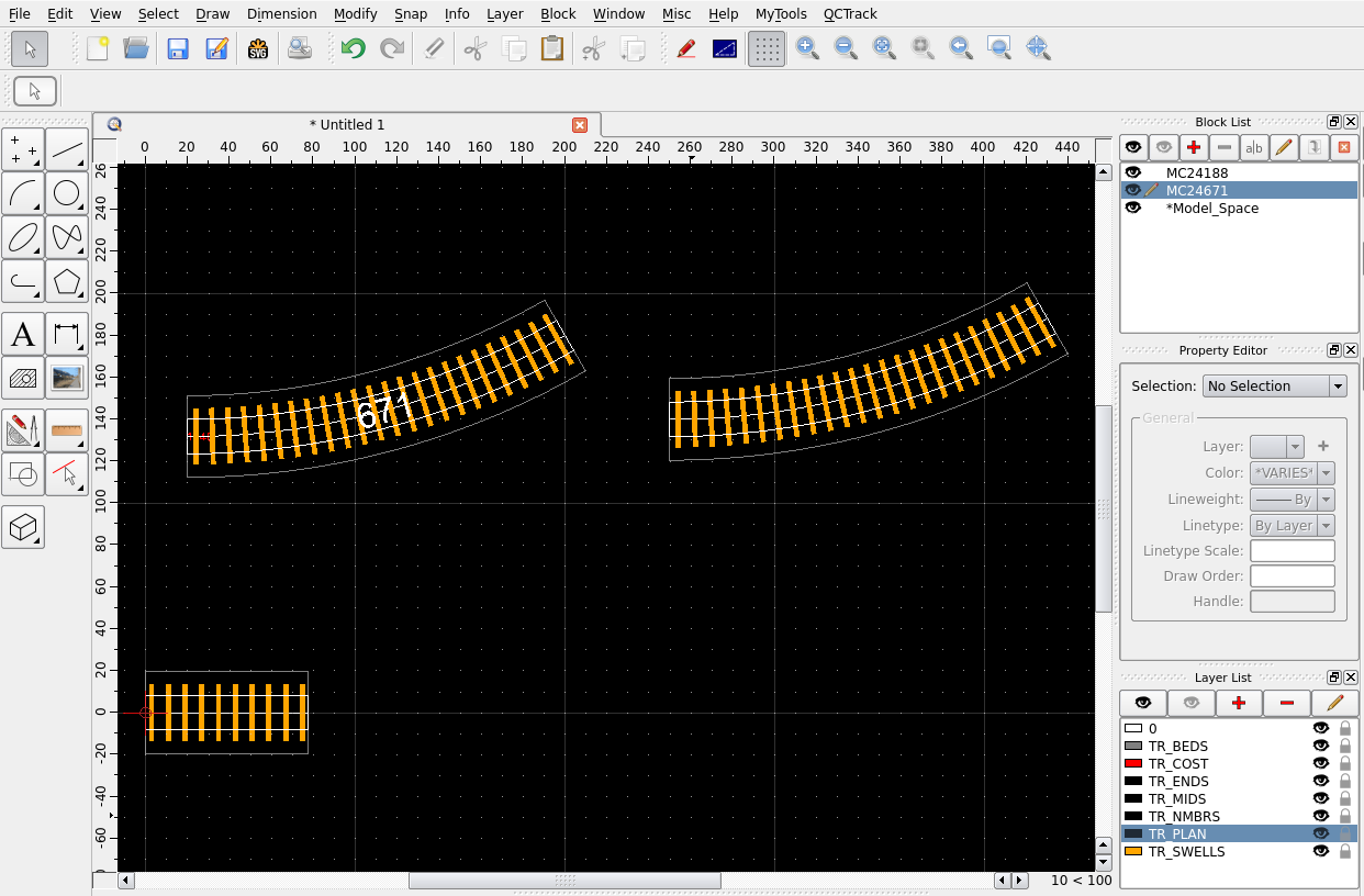

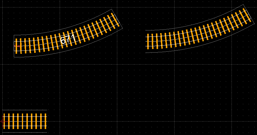

To create more complex elements than just straight or curved elements, you may edit the created blocks as needed. In this example, I will show the required steps to create a curved turn out like Maerklin 24671 which has 360mm radius and 30° curves which have an offset of 77.5mm.
First, create the "base" element just like a "normal" element: At the Model_Space (the normal work space, not inside any block), create a new curved track via QCTrack / Create menu:
Then, change the current block space by double clicking the newly created MC24671 block in the QCad Block list. You now should be able to select elements inside the newly created MC24671 element. Select all elements and move them all together some distance away (we will need them later).
Next, again select QCTrack / Create, but this time leave the "block name" empty (maybe you will notice that the top check box is deselected and the cursor starts in "Display name" instead of "block name"). Leave "Display name" empty, again enter 360 / 30° at the bottom of this dialog and hit "Ok". Again move the created element away.
Now for the third time select QCTrack / Create, leave "block name" and "Display name" empty and enter "straight 77.5" to create a straight element.
Your QCad window should now look similar to this:
Now select only TR_PLAN to be visible. Remove the short ends of the straight element and the left end of the curved element without display name.
Remove the same lines on TR_ENDS and the something longer lines on TR_BEDS. (Means: you remove three lines on each of those three layers.)
All layers visible now you have:
All parts are created now, so let's move them to the appropriate position with the normal QCad command (like "mv" for move with "se" for snapend using the bottom left ends of the bed lines):
Now adjust the lines on the TR_BEDS layer as wanted. For me, the following seems to be appropriate (deleting and trimming lines):
As last step, mark all layers to be visible and select QCTrack / Ensure order of track layer objects. This should put the swells to the back and bring the display name to the front (and also sort all other elements). You should now have:
Of course, you may edit the swells to look more like they realy do, but this isn't needed. Very importand is only one thing: there must be three (not four, not five, and, of course: not six) lines on TR_ENDS, because all other QCTrack-scripts use the lines on TR_ENDS to connect track elements. So double check if your block has three lines (e.g. select only TR_ENDS layer to be visble and select all elements, then QCad should display "3 Lines on Layer 'TR_ENDS'").

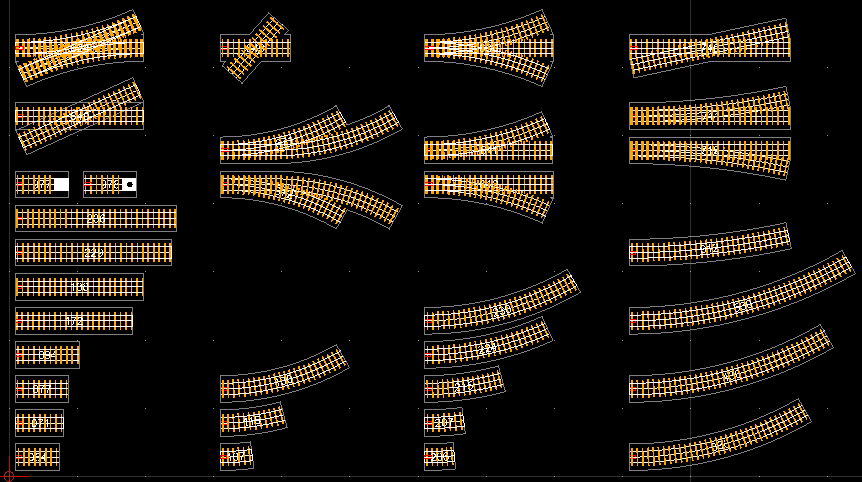

As described in step 2 and 3, create all your track elements, insert each block once and save :D this file. For Maerklin C-System tracks, you get something like this:
Of course, for Maerklin C-System tracks you may just download my library MaerklinCGleis.dxf from the post above. :D There some plan examples are included, too.

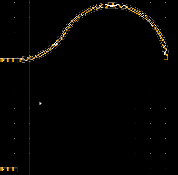

To build a new track plan, insert the first block somewhere with the usual QCad functions (e.g. select one at the Block List and insert it or just copy it from your "library" area) or via "QN" (QCtrack / Insert new track from track widget) after selecting one in the track widget (see next tutorial). Ensure to have an appropriate layer selected, for example "playground" or just the "0" layer. Do not use any of the TR_* layers to insert blocks to.
QCTrack then supports plan building with several functions:
  • Movement of elements: Select the element(s) to be moved, type "QM" or select QCTrack / Move from the menu, select the track end to connect to another existing track (mouse-over a selected track will show a auxiliary circle) and then select the destination track end. All selected tracks will be rotated and moved to connect the selected track ends. All attributes of all elements will be unchanged.
  • Duplication of elements: The user interface is the same as for movement of elements, but you must type "QD" or select QCTrack / Duplicate and move from the menu. The selected elements in contrast to Move will be copied with the current attributes (i.e. the currently selected layer!).

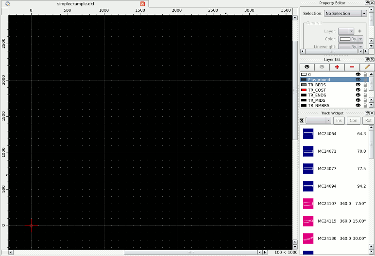

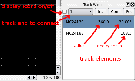

Thanks to perstistent asking :wink: of Husky, there is a Track Widget :) that can be enabled / disabled via menu item QCTrack / View track widget or "QV". You then get something like the Block list but with some more information about the tracks you may add.
To place an unconnected track, select a track from the track widget and click "Ins" or choose meu item QCTrack / Insert new track from track widget or type "QN". You may place it everywhere like a normal QCad block. To extend an existing track, select a track from the track widget and click "Con" or choose menu item QCTrack / Connect new track from track widget or type "QC". With mouse over the existing track, there should be preview of the track that would be inserted on left mouse click.
Even during preview, you may type "QR" or click "Rot" in the track widget select menu item QCTrack / Rotate track at track widget (or you may right click inside the track widget or select a track end from the combobox or hit the Rotate button at the track widget) to select another track end to connect.

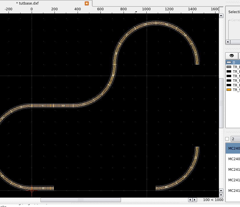

Below you see an example of how to use the QCTrack align function. If you have one or more tracks that should be aligned to another track but moved only on an (may be arbitrary) axis, you can do this:
  • Select tracks to align.
  • Select QCTrack / Align or type QA.
  • Select to-be-aligned track end.
  • Select target track end.
  • Select track axis.
At the start of the animated GIF the three curves are inserted via Track Widget in combination with QC and QR (connect new track and rotate).

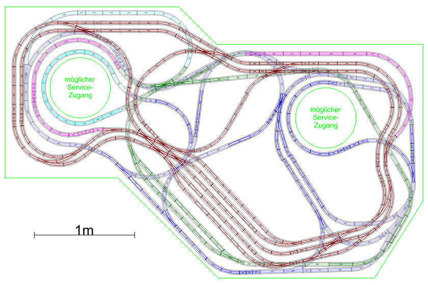

Post by smf » Sun Mar 01, 2015 8:24 pm
Attached is a dxf example plan for Maerklin C system which looks like this:
Mäklin C-Gleis example plan image
