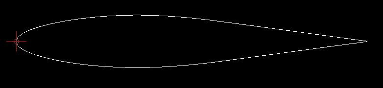

Re: aerodynamic profiles
Maybe the attached is similar to the solution you seek. It takes a text input file of x,y pairs and connects adjacent points. I used it to construct an airfoil shape from data someone posted, I think here on the QCAD forum.
Just copy the folder into the scripts folder and you should be good to go. It's set to split the text on commas, but you can change that in the code. Also, it zooms to the points imported, and if there's a bread in the data, it doesn't connect adjacent points.
Sorry, I don't seem to be able to delete what appears to be a duplicate of the image below.
