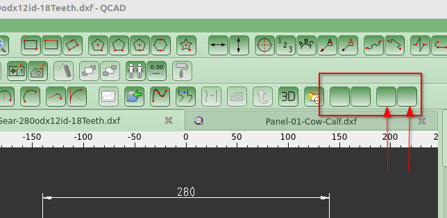

On the same subject, I would like to know how I can add these icons to the existing blank
icons shown on my "User Toolbar 1".... I know I can save them to svg but when the scripts are embedded into a release is there a way to do this?
The two buttons are "Make All White Layers Black" & Make All Black Layers White" Cheers
