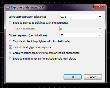

Wrote a little GUI tool for direct access. :P
Shortcut is XX and it is listed in the Edit menu below 'Application Preferences' with an icon.
A dialog is shown with the XP preferences, fully compatible with the default preference panel, Pro or CE.
Implemented the OR clause as per Feature Request FS#2653
:arrow: Splines per approximation OR per interpolation.
The dialog showing my current preferences
