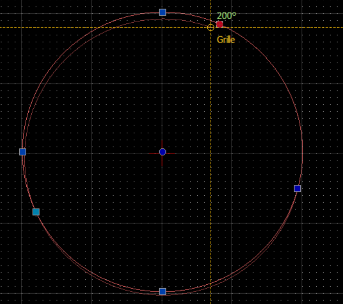

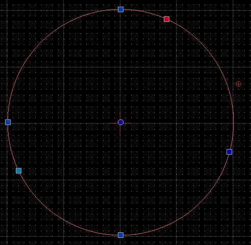

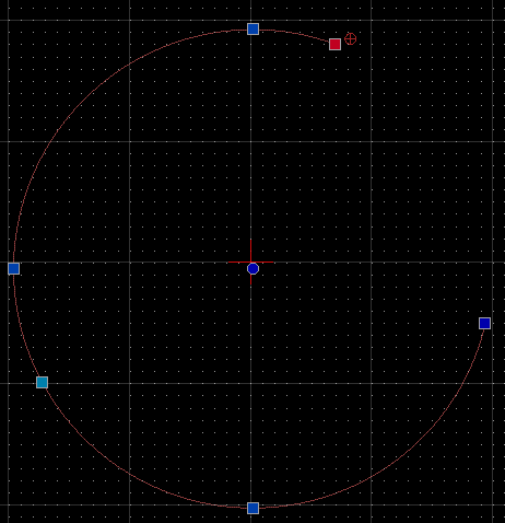

Also, strange thing but when I try for example to do:
const Cx=1; const Cy=2; const R=200; const alpha=20; const beta=50;
var center = new RVector(Cx,Cy);
var di = this.getDocumentInterface();
var document = this.getDocument();
var op = new RAddObjectsOperation();
var entity = new RArcEntity(document,  new RArcData(center, R, alpha, beta, false));
op.addObject(entity);
di.applyOperation(op);
well, it prints me a circle:
Capture d’écran 2023-06-15 094939.png (8.55 KiB) Viewed 143705 times
but when I try to move a point:
Capture d’écran 2023-06-15 095430.png (76.47 KiB) Viewed 143705 times
now it transform it into an arc:
Capture d’écran 2023-06-15 095524.png (7.77 KiB) Viewed 143705 times

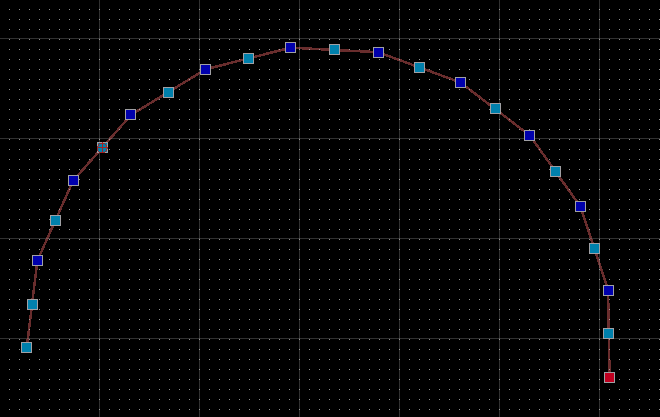

For some reason the polylines have 1 extra duplicated node at the end. :o :(
Probably the sum of things doesn't exactly match with the arc endangle ... = polar based.
Maybe this doesn't occur when we approximate the arc angle based .... Untested.
Tested and the results vary. :roll:
Solved by checking and removing/replacing the last vertex:

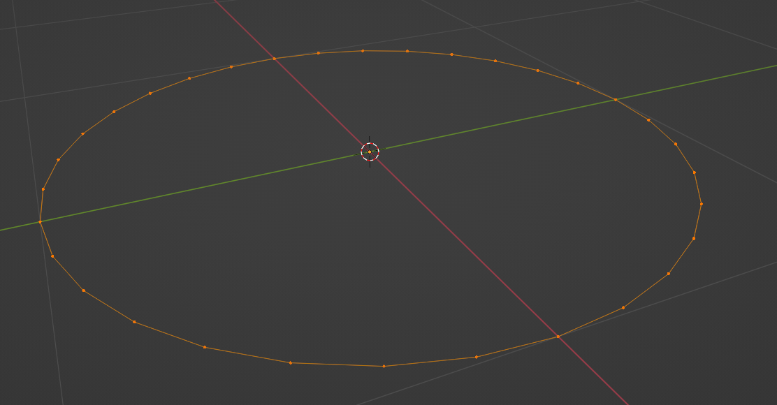

We then store the .dxf and reuse it later into Blender. And Blender likes points.
Meaning Blender can't handle arcs? :shock: Is that for sure? :roll: :!: :?: OK, noted :lol:
Yeah, for example, here is the very first basic circle mesh you can add on Blender.
Capture d’écran 2023-06-19 093036.png (7.98 KiB) Viewed 143402 times
Where do you the a duplicated node? Can you give me what you are testing so I can reproduce?
