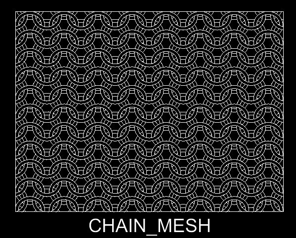

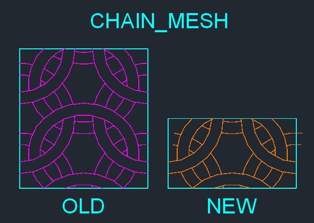

Hi All
I needed a fair bit of help with this one so credits to CVH for all the trials he did to make this pattern possible :)
Pattern design by myself and the hatch pattern generated with Tile2Hatch b17 Copyright CVH..
CVH Changed some of the entities so this pattern could hold steady at 100,000 tiles from datum.
Some of the line endpoints in this pattern don't touch, this was necessary to maintain a stable pattern at a distance..
PS I forgot to mention, this is a strange beast the Imperial master tile is not 1x1 it is 1 X 1.090909091
and in Metric it is 25.4 X 27.7090909114 [ This is a rectangular hatch tile ]
OK Now we have a pattern half the load and very stable, credits to CVH on this one see image..
Also keeping both patterns so people can see the difference a well thought out pattern can make...
And don't spend all your time thinking about the design :)
Just Copy new patterns over old ones...
BETTER PATTERN Credits to CVH
CHAIN_MESH_MOD NEW - Metric & Imperial.zip
(5.35 KiB) Downloaded 1465 times
OLD PATTERN
CHAIN_MESH Hatch Pattern - Metric and Imperial.zip
(8.06 KiB) Downloaded 1433 times

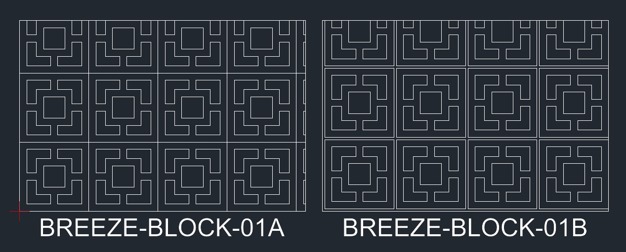

Hi All
Testing CVH's Tile2Hatch, thought I'd give the Orthogonal Tile Spacing a try out, IMO it works well and very useful :D
This is a Standard Retro Style Breeze Block in Australia the standard size in Metric is 290 x 290 with 10mm Appox Mortice Gap.
Sooooo the Imperial tile is 1x1 but the Metric one is 29 x 29 " or very close to it " so the user can have a preview of the pattern otherwise you wouldn't see a preview if I did it at 290 x 290 :) , if you want it to scale you will need to scale the hatch pattern by 10... 8)
Types A will have no Gaps
Types B will have Gaps
Enjoy, I have a few more on the way :)

Hi John - thank you!
John Hyslop wrote:
Sat Mar 06, 2021 7:50 am
BREEZE-BLOCK-01 A and B - Hatch Pattern - Metric and Imperial.zip
BTW: Please rename your source folder for the zip from Mertic into Metric. Thanks. :wink:

Thanks John.
I wouldn't expect otherwise. :wink:
What really happens is that the 'Tile' grows a certain void space up and right.
And that was made fully possible by the non-uniform 'Tile' math.
Now shifting ... and adapt/rewrite the math to do so. :wink:

Oh Shit... Sorry about that... the last few have been the same oops... :oops:
I've updated this one but letting the other ones go... Folders now renamed so hopefully it won't happen again :oops:

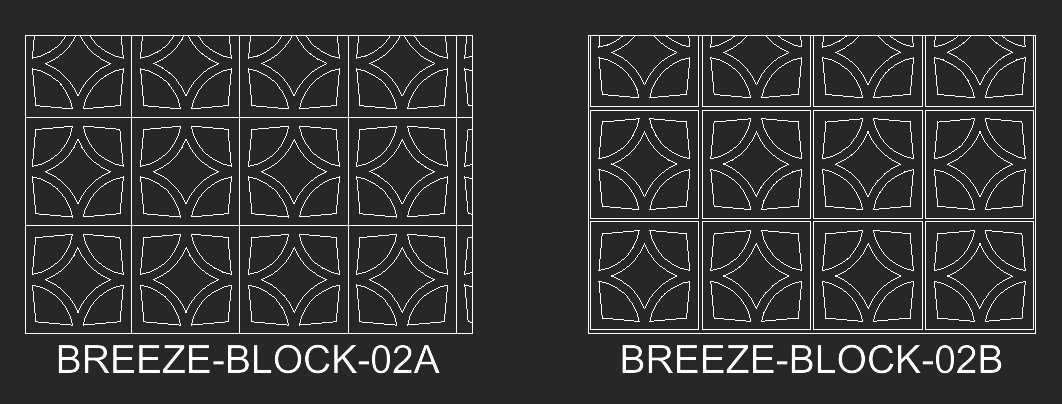

Post by John Hyslop » Sat Mar 06, 2021 9:38 am
Hi All
As Above you need to scale the Metric one by 10 if you want it 290 x 290 1:1 Size...

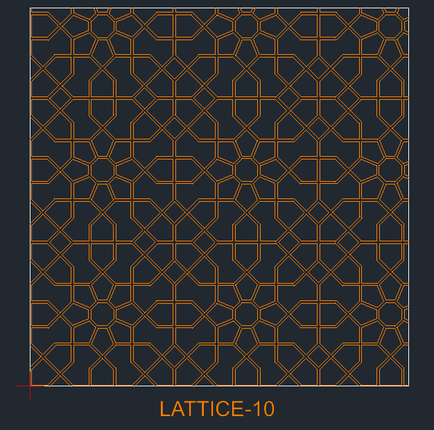

Post by John Hyslop » Fri Jun 25, 2021 8:49 am
Hi All
Well it's been a while but here you go, an addition to the lattice set..enjoy :D
You'll need to scale the pattern up quite a bit if you are making screens, I had to make this small to get all the detail in :)
LATTICE-10 - Metric and Imperial.zip
(6.12 KiB) Downloaded 1450 times

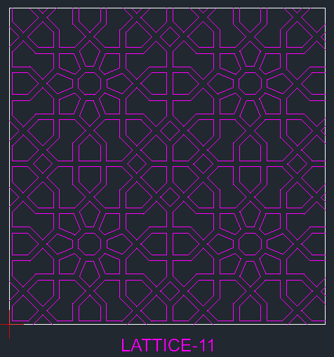

Hi All
This one has thicker lattice....
LATTICE-11 - Metric and Imperial.zip
(5.4 KiB) Downloaded 1394 times

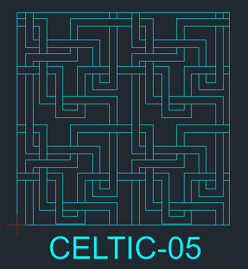

Hi All
I'm on a roll :lol:
You'll need to scale the pattern up quite a bit, I had to make this small to get all the detail in :shock:
CELTIC-05 - Metric and Imperial.zip
(1.82 KiB) Downloaded 1399 times

WOW John, are you the love child of M.C. Escher :lol: Those last three are mind blowing e_ugeek e_ugeek

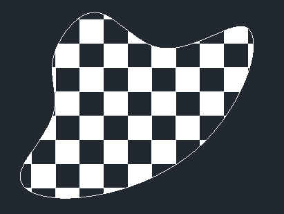

Post by John Hyslop » Sun Nov 07, 2021 7:46 am

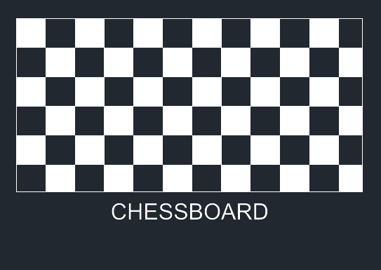

Hi All
It's been a long time but hopefully I'll have some time now to do some hatch patterns..
I'm thinking a little outside the box here playing with fills which can vary quite a bit depending on your lineweight but I think it's worth playing around with, anyway here's a chessboard pattern it will be one of a few that I'm going to experiment with.. :)
Chessboard - Metric and Imperial.zip
(3.16 KiB) Downloaded 1239 times

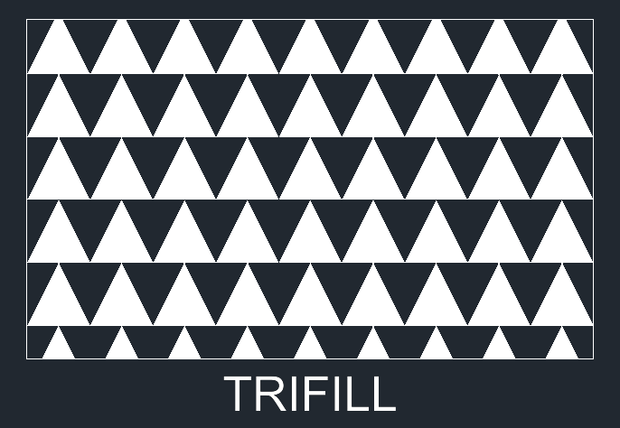

Re: Free Hatch Patterns

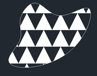

Post by John Hyslop » Mon Nov 08, 2021 7:23 am
Hi All
TRIFILL " Triangular Fill Pattern"
TRIFILL - Metric and Imperial.zip
(3.14 KiB) Downloaded 1364 times

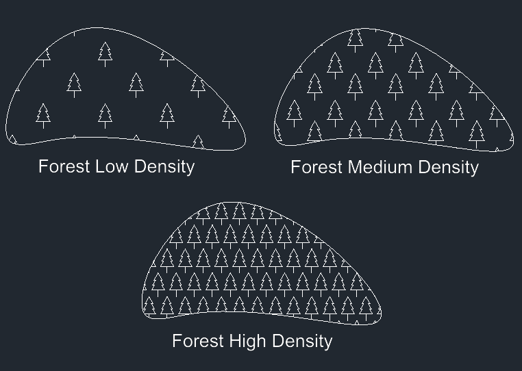

Hi All
Here's some useful hatch patterns for landscapers , three Forest Patterns
in Low, Medium & High Density..
Credits to Husky for the concept design & suggestion..
Forest - Metric and Imperial.zip
(4.43 KiB) Downloaded 1343 times

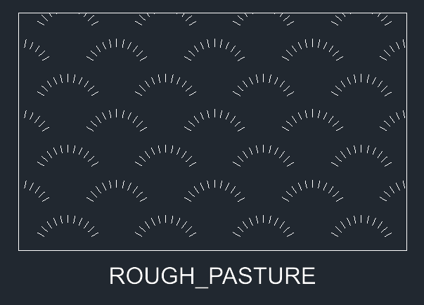

Post by John Hyslop » Mon Nov 15, 2021 7:59 am
Hi All
Some Map Related Hatch Patterns Coming Up..
Design by Husky..
ROUGH_PASTURE - Metric and Imperial.zip
(1.85 KiB) Downloaded 1285 times

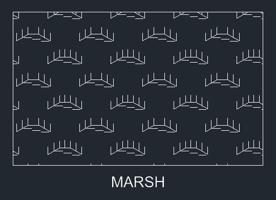

Post by John Hyslop » Mon Nov 15, 2021 8:20 am
Hi All
Design by Husky
MARSH - Metric and Imperial.zip
(1.51 KiB) Downloaded 1273 times
