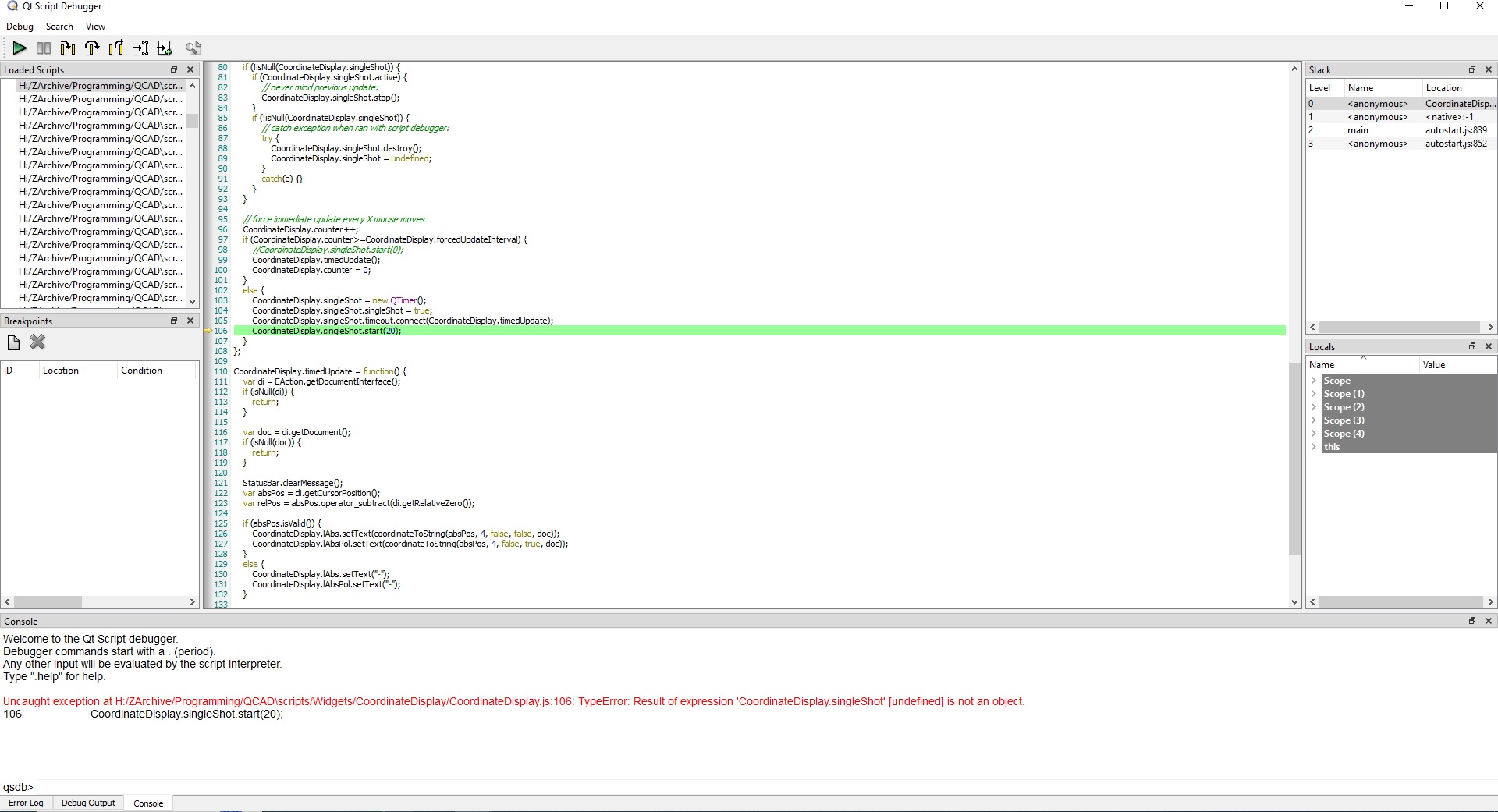

Hello everyone.
I generally run qcad with the debugger enabled (for debugging my own scripts) and I seem to randomly get an error popping up from CoordinateDisplay when using the program normally. It seems to happen when I'm just clicking on stuff and it doesn't happen too often. I took a screenshot of the debugger window that popped up as a result (see attached image). Seems like a weird error. It is saying that CoordinateDisplay.singleShot is not an object (undefined) even though it apparently wasn't undefined on the previous line? Any ideas?
- CoordinateDisplayError.jpg (322.12 KiB) Viewed 53239 times

Unfortunately, this is happens because events can occur in the wrong moment while debugging since the debugger forces event processing while running a script. For the same reason, the Qt script debugger can also cause random crashes and should only be enabled when really needed. Note that with Qt 6, the debugger has been removed completely.333onlyhalfevil wrote: ↑Wed Dec 04, 2024 3:14 pmI generally run qcad with the debugger enabled (for debugging my own scripts)

i got sick of this one popping up randomly and ended up fixing it. You can fix it by editing the following file https://github.com/qcad/qcad/blob/f06ae ... lay.js#L25 as follows:
The problem is that an undefined gets passed through the script sometimes and causes the debugger to pop up. Line 81 in CoordinateDisplay.js checks if CoordinateDisplay.singleShot is null. Add in another check to make sure CoordinateDisplay.singleShot is not undefined like so: && CoordinateDisplay.singleShot != undefined. You also need to change line 107 to an else if and add in the same two checks for null and undefined. It hasn't popped up since making these edits.

CoordinateDisplay.js is typically only included as compiled in a standard installation.
Meaning that we have to supersede it with including a custom copy ourselves and the required folder structure + whatever required.
Odd is that isNull(obj) is said to check if the given object is undefined or null, see the library.js script.
The extra test on 'undefined' on line 81 should be obsolete.
It would then fail in line 82 checking the active state of not a QTimer.
I can't let it misfire on purpose with flawless scripts at the moment and can thus not verify if that is the case.
Your own screen capture above displays the error at line 106 (That is from before Commit 5a73fc9 .. Oct 20, 2022)
Mentioned yourself, set to a QTimer on line 103 but failed 3 lines lower.
You can not catch this off by an extra test on 'undefined' in line 81 or 107 (current state).
Because it would fail somewhere between 107 and 111 (current state).
Events are simply not executed at due time or in the correct order in debugger mode.
Things may happen between evaluating and executing 2 lines of JS code.
But if it fixed all of your issues with singleShot ... Then why not.

Interesting. It looks like the comment says that it checks for undefined but the code itself does not. It appears to only check for if the object is deleted, if its null, and if it has a typeof equal to "function". Maybe a simpler solution would be to add the undefined check within the isNull() function. A quick internet search for isDeleted says an undefined is only used in the case of arrays. Maybe that is the confusion.
My memory is a little fuzzy on this since I posted it awhile ago but I seem to remember the error line not being the same line every time the debugger popped up. It always seemed to fail on either line 84 or lines 108-111. It's possible that it is still a problem within flawless scripts because if you continue running after the debugger popup, it will just keep going until it gets back to the beginning where CoordinateDisplay.singleShot gets assigned a value.
This is a good point. Maybe its not completely fixed in that case and it'll end up popping up again eventually. It certainly helped though.CVH wrote: ↑Thu May 15, 2025 11:45 amYour own screen capture above displays the error at line 106 (That is from before Commit 5a73fc9 .. Oct 20, 2022)
