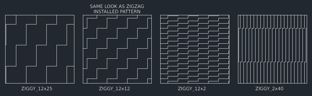

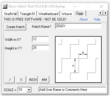

I just added a new pattern I called it Ziggy because Zigzag already exists in qcad patterns, this new pattern gives you a little more flexibility with options to change X and Y line lengths "the gaps in between the lines are the same distance X & Y..
That's a total of 14 user adjustable hatch patterns :)
Other changes are as follows:-
BHT is now compiled into a Setup file.
"Add User Name or Comments Here" now clears when you click on it and whatever the user types in is retained throughout until the application is closed.
Help file is now added to the menu "in RTF format."
A folder is included in the zip file "Additional files" for some light reading and viewing :D

Here are some samples using the new pattern..

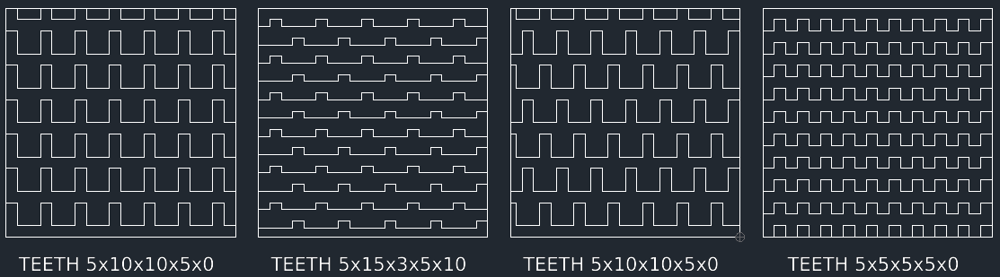

This New Version Has a Pattern Called TEETH :)
It Works on All Versions of Windows 7,10 & 11 32/64bit, it's a 32bit Application & Also Runs on Linux if you have WINE or PlayOnLinux installed...
The Help menu now displays as a pdf file that has information on the program plus an image UI layout with explanations.

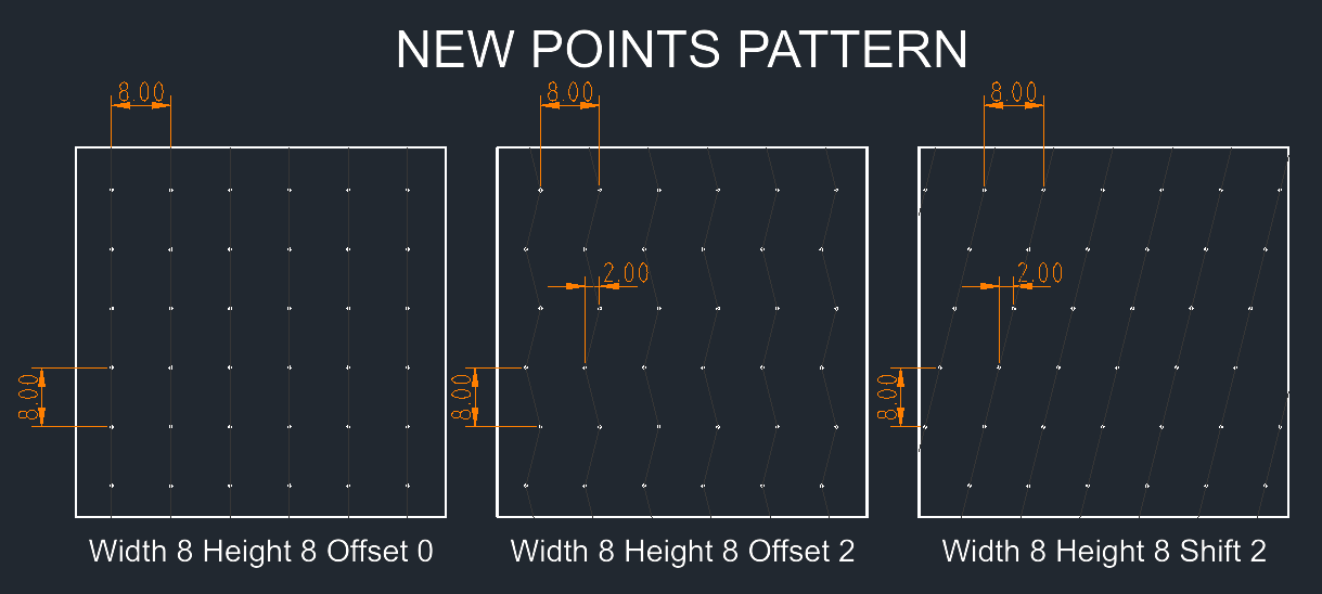

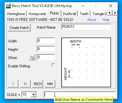

This Version Has a New Pattern Called POINTS :)

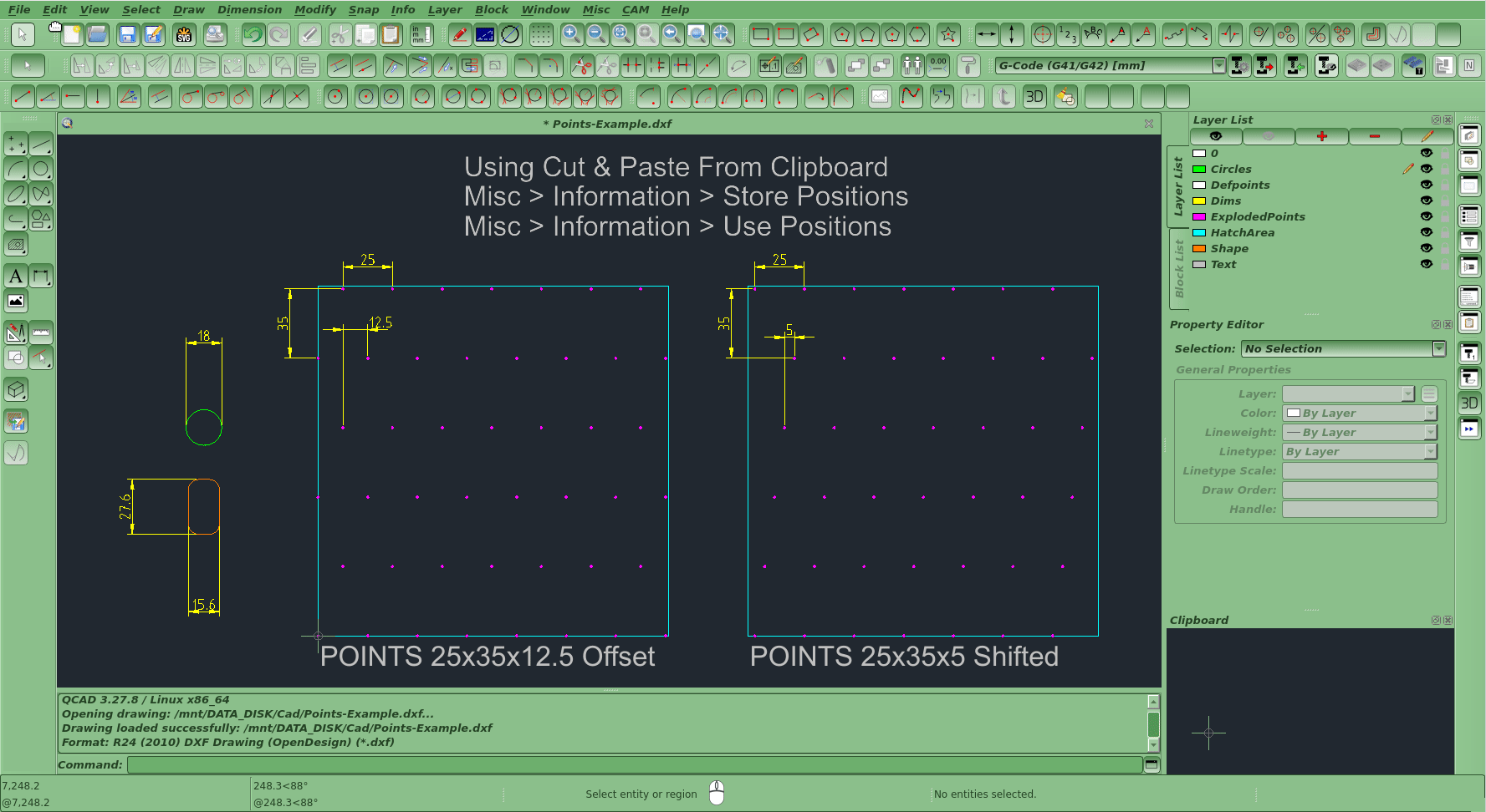

You might ask yourself "What's the POINT of POINTS" ? :?
Well thanks to Husky who showed me an Example of what it could be used for when applied and exploded..
So you see it can be useful for " Rectangular Arrays / Offset Arrays & Shifted Arrays.." as well as just hatch patterns :)
