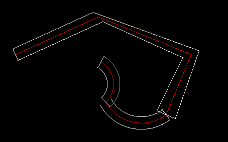

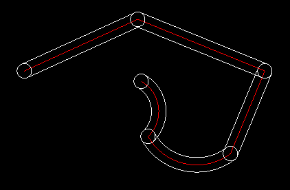

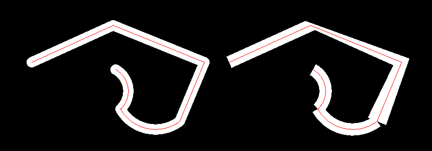

- Posts: 4902
Re: How to get coordinates according to step value
WildWolfCJ,
Reviewing your other topics it seems you are asking the hard to answer CAD questions and that is a bit like mine.
There is no simple offset shape half the pen size away of an ellipse.
Nor are there splines that are an offset of quadratic/cubic (degree 2/3) splines with a reasonable polynomial degree.
On screen/paper this is rendered as a bunch of short straight lines for simplicity.
Arcs/circles are also handled segmented although offsets to these exists, mathematically it is much easier.
You may notice the segmentation when zooming in quite deep on curved line-art.
The left and right offset shape of a line segment is straightforward and always fairly correct.
At endpoints or at corners it is merely adding a circle with the diameter of the round pen to represent Lineweights and merging all the filled area.
QCAD has no concept of merging areas.
Connecting each set of offset shapes their start-points and end-points is similar as using a flat pen for polylines with custom widths.
Although the rendering of polylines with custom widths is a hybrid.
Where 2 line-segments meet, a miter join is used, otherwise but cap's are used.
The vector data of both examples is identical, the difference is the usage of a round or a flat pen.
The right example polyline with custom widths can be exploded to its contours ... = Plural:
I think that you can notice one of the flaws of exploding a polyline with custom widths at first glance.
Only where miter join's were used the contour is continuously, otherwise the partial contours have a gap and overlap when not tangent.
At discontinuities one could imaging that the flat pen stand still and rotates around its center until closing any gap, until re-aligned.
I once presented an adapted XP tool mimicking this behavior, meanwhile correcting flaws, but that was rejected.
As engraver I need the contour to be singular and flawless for pocketing.
There is no method to explode line-art Lineweights to contours.
Something similar can be achieved with a uniform offset to vectorized shapes and nodes for a certain Lineweight.
Two continuous poly offsets with round join's and round cap's at endings works too ... If offsets at touching arcs would never fail.
What remains is fixing the flaws (ifso) and merging the contours to a single outline.
Easier said than done.

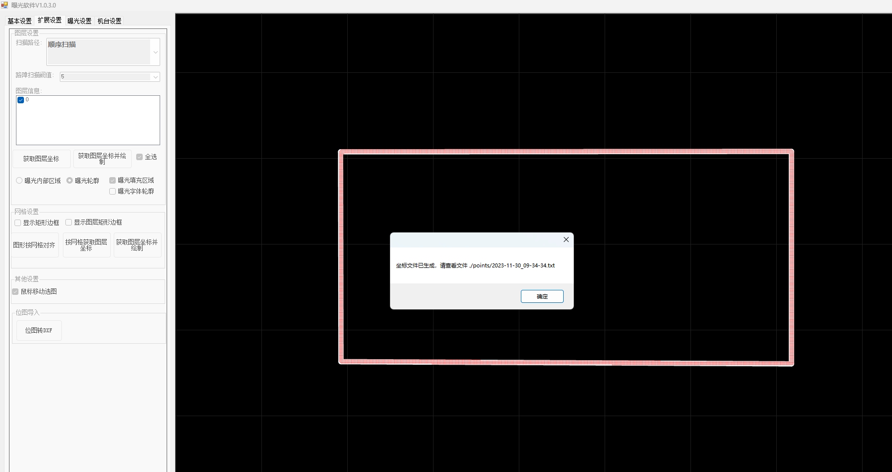

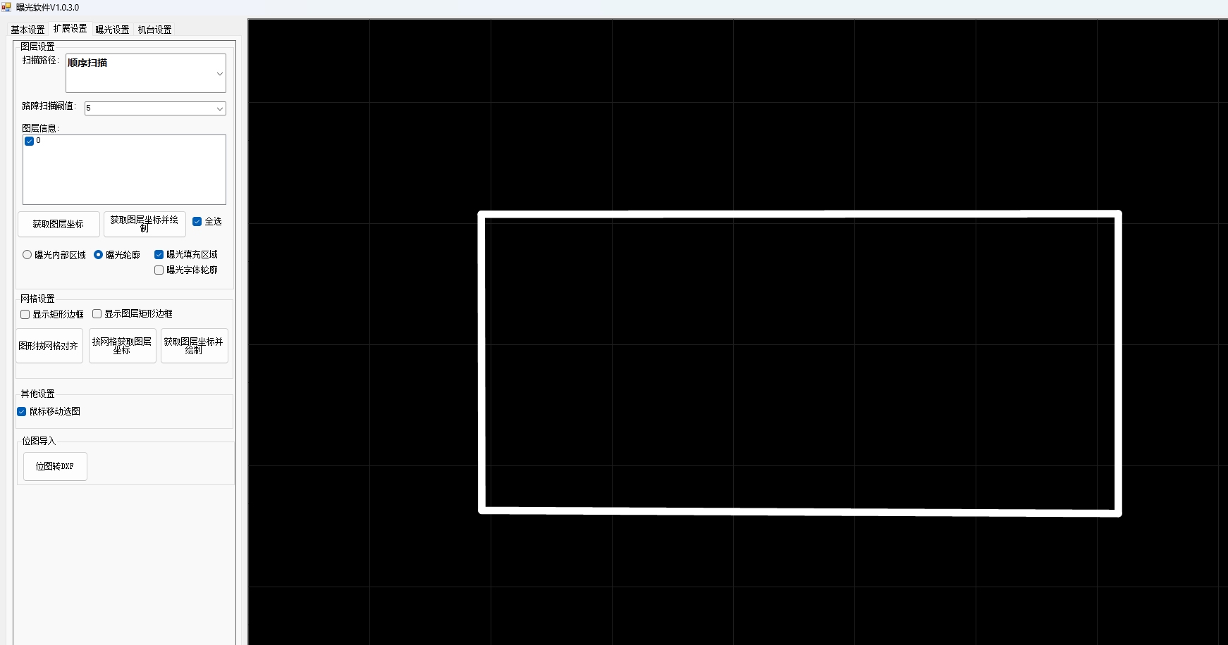

HI CVH Thank you for your patient answer. The attachment is a simple DXF file containing a rectangle with a pen width of 2.11nn. I display this graphic in my program and get the coordinates and save them to the file. They are the coordinates of the red points discussed above. The method I am currently using to obtain coordinates is not very scientific.
- VeryCapture_20231130093411.jpg (161.86 KiB) Viewed 73781 times
- VeryCapture_20231130093449.jpg (199.04 KiB) Viewed 73781 times
- VeryCapture_20231130093509.jpg (181.34 KiB) Viewed 73781 times

Right, rather obscure.
Recieved a drawing with a single logical closed polyline in the shape of an irregular quadrilateral.
The single entity on layer 0 has a custom set Lineweight of 2.11mm.
Red dots are not included ... Those are probably not even generated with QCAD.

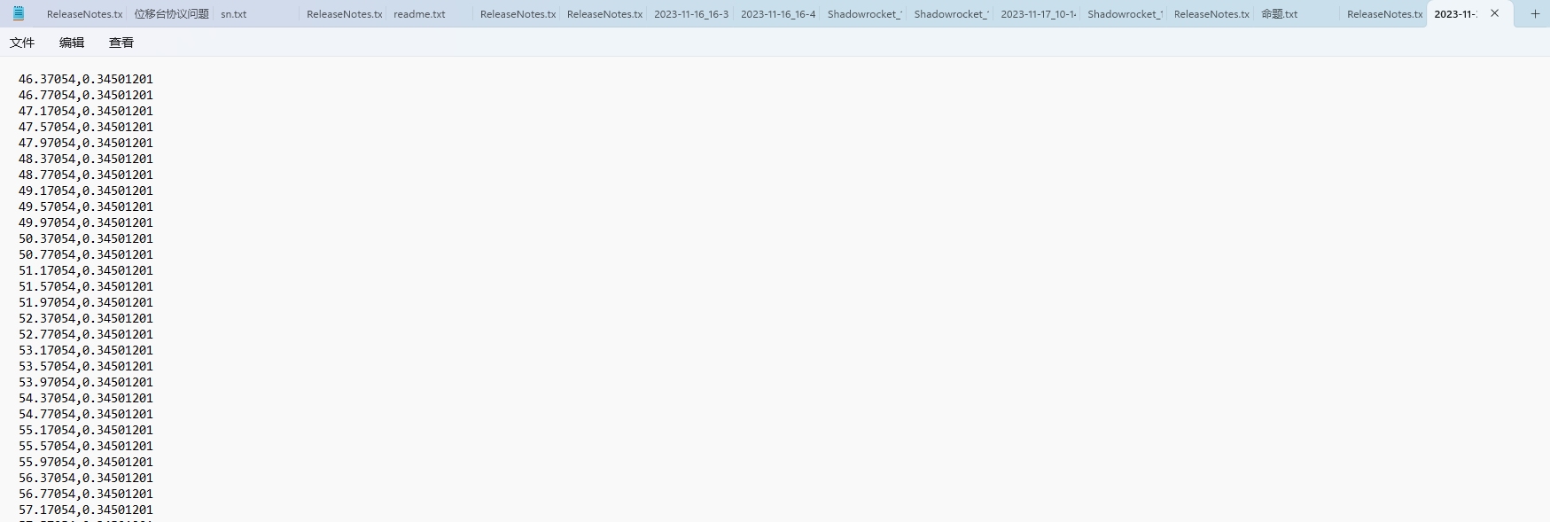

The text file with CSV data is not attached.
While the bottom line segment is slanted for 179.72716502° I see an export for X from 46.37054 to 57.17054 where Y is stable at 0.34501201.
The first reference I have to work with is 1.05321157270302312mm from the center, the last is 1.00178358435491432 from the center.
Both within half a pen diameter of the lower quasi horizontal line segment.
In a way this looks like rasterization with a step value of 0.4mm.
First unknown is where the origin of the rasterization is.
The decimal fraction of your exported coordinates do not align with any of the 4 corners nor with an 1.055 offset to that.
From data I suspect that origin is at (0.37054000, 0.34501201) with 8 decimal digits.

I suppressed the original polyline on Layer 0.
Added the vector art in red.
Added 2 offsets half the pen size.
Done in the QCAD GUI but feasible with OffsetProWorker.js because it is so trivial.

Nifty solution:
I created a Hatch Pattern with dots 1 units spaced, used at scale 0.4 and a zero degree angle.
Hatched the area between the contours and set the hatch origin afterwards.
Exploded the hatch to points and exported these points coordinates to CSV.

Thank you very much for your reply and guidance
My requirement is that the customer gives me a DXF file, and I need to use SEM to engrave the graphics in the DXF file. Because SEM engraves using dots, I must first convert the graphics in the DXF into coordinates.
Because I am a newbie in this industry and I don’t understand many things, so it is very difficult for me to do it.
Thank you again from the Far East
SEM does have a higher resolution than 0.4, this value can be setAnd that the resolution is far better than your 0.4mm ... Rather more something as 0.4 micron.
Yes, this is the function I mainly develop,Obtain the outline coordinates of the solid graphics in DXF, or obtain the filling coordinates of the closed graphics, which is also optional.Gathered from other topics I then come to the conclusion that you have line-art mixed with text-art.
And that you need to pocket the outer contours of all that art with dots.
Yes, absolutely correctAs if a Drill toolpath but rather not for drilling, instead it is firing the beam at given coordinates.
This is the first time I have heard of this plan. I will check the relevant information, or can you give me some guidance?Fully done with QCAD I think you are better of with the 'Nifty' solution.
Now I only deal with polylines, line segments, circles, arcs, ellipses, fonts, and these graphics with pen width (there are still bugs), and I can't handle complex graphics yet.Please provide an example drawing with all kinds of drawing art that you may encounter.
How should I do this? I have no idea at allA script at GUI level can be called as per OS Command Line resulting in a CSV file with coordinates.
