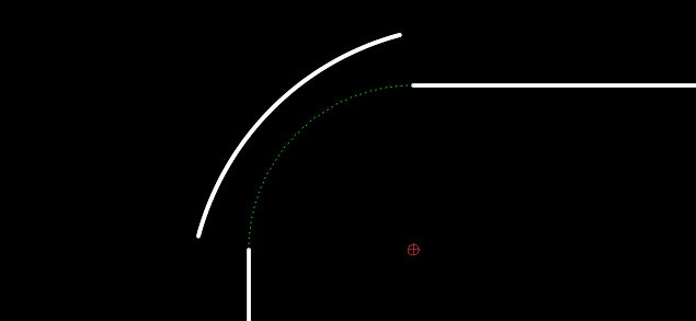

-> For not straight segments or newly created RArc shapes the 2D length is measured as the absolute sweep angle in rads times the radius.
Important here :!: : The vertex data or endpoints for such an Arc shape can/may NOT be defined in 3D with the result shown below.
For QCAD, an Arc shape can only exist in a flat plane.
Any point on the curve, including start and end is at the same level in Z as the center position.
The same is true for a Circle shape and the related Ellipse shape.
The method is not guarded for this and the summed total length is faulty in every perspective.
Without additional data to slant the plane in 3D, an Arc in top view from 2 points in 3D is part of an Helix where the pitch (dz) can be zero or not.
Similar to a G-code motion G2 or G3 where Z is not equal to the previous position in XYZ.
White is one polyline as rendered by QCAD, dotted green is the intended bulging segment (90°)
