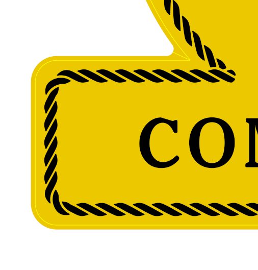

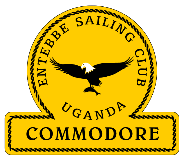

Hello to you all,
Here goes nothing....
It started with an order of my old mentor in engraving.
He is retired and lives partially in Uganda these days.
The order was to make 14 badges as relation gift.
The first pic is the design I got from him, the second is what I proposed.
I followed a tube on how to flex the rope manually.
Drew 1 corner with Qcad and cloned it 3 times.
The badges are allready donated a while ago.
Engraving them was a whole other story.
Sharpest detail radius is 0.08mm in engavers brass.
But something kept me coming back to it.
As it was merely slicing the 'painter' and recasting it orthogonal on the bend.
A script could do that.
And it could do that with any 'painter' or lines, dots, ....
It is that versatility that drived me in coding it.
For now, the zip package is intended to be extracted to QCAD\scripts\Misc\Examples\MathExamples\
In there is a subfolder 'FlexPainterTemplates' with 2 dxf drawings.
A tutorial on how the painter is constructed, and one with a bunch of test cases.
On a win system they might beter be moved out of the protected OS portion.
Its stable and works exactly how it is intended.
I came to a point where I need some input of the community.
There is a lot of info inside the script file. Look also for 'ToDo' and 'Issue'.
A large remark block is at the end of the script.
These are not intended as a thousand questions in one post.
They are my guidlines to start asking questions or simply not to forget anything....
It might that the coding is horrible, not Java minded, nor Qcad minded, nor proper coded.
But you have to look at the potential far beyond casting a rope.
As I hate to be verbose the tool is persistent verbose.
I like to hear the others their opinion, and if any, about unknown issues.
In the long run I see it to be promoted out the experimental level.
On simple request I will redraw the proposition.

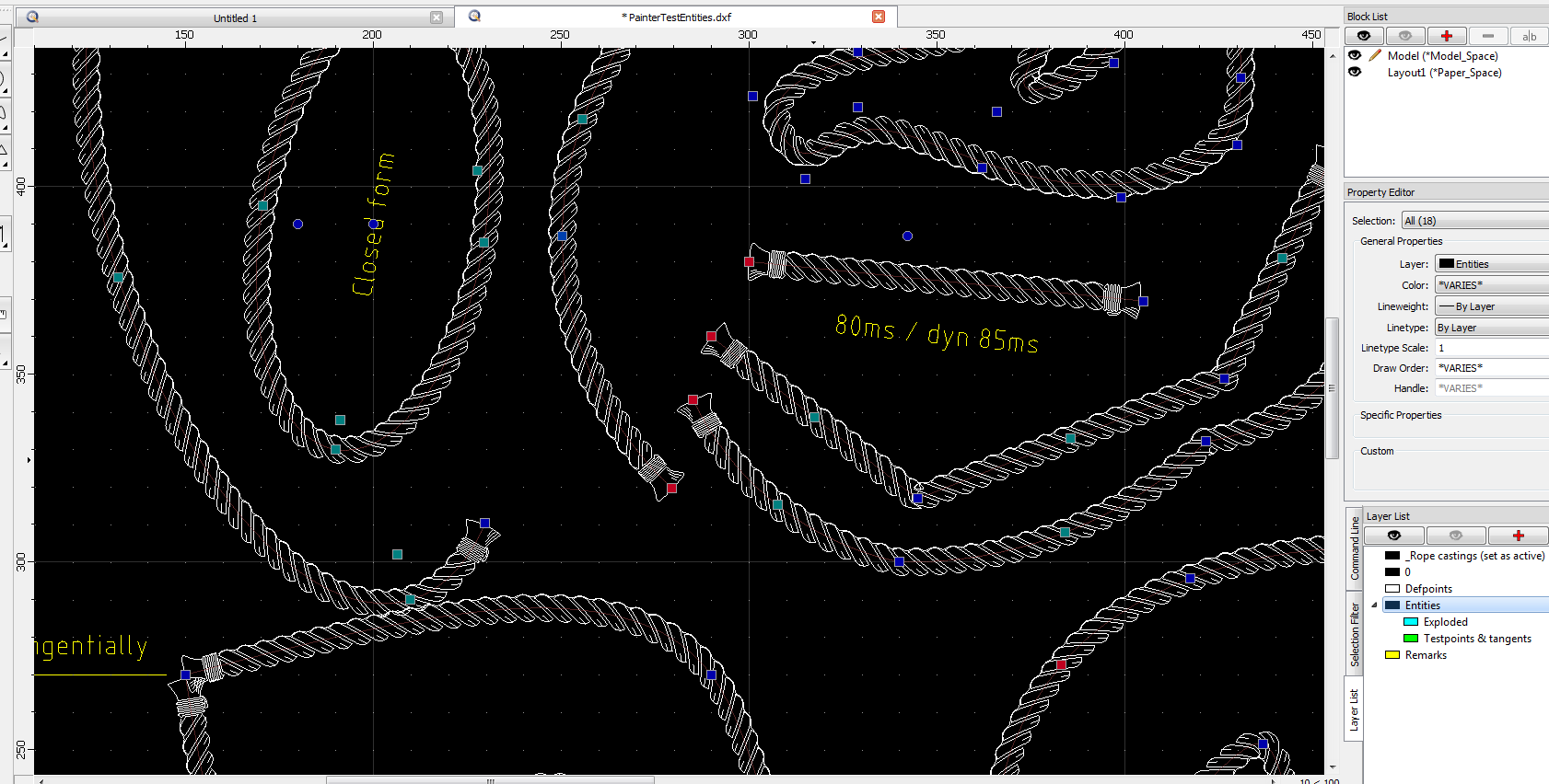

Re: FlexPainter beta 0.34
The script adds an entry to Misc| Script Examples | Mathematics | ..
The script mimics a roller stamp that travels along the selected base curve.
Pictures say more then words.

- Posts: 5002
Thanks Andrew,
much appreciated coming from you.
Please read inside the script.
The math was simply cast left , cast right.
But then it evolved in several stages.
All curve-based
Nice endings.
Apexes.
Dynamically scaling to a closed form (without apexes)
The idee of insertions eg. a knot in this case.
Global casts along the base curve.
Margin crossing.
The FlexPainter having the flaws in steep curves is error-like but it is super realistic.
Twisting a roller stamp to much will smudge.
What about chain-like behaviour?!
Or common stamp like?
But that is all artistic stuff.
Its also a base for more technical stuff with a custom well defined painterset.
Repetitive texts if you like.
Splines through offsets at regular intervals.
Endless
Thanks, again

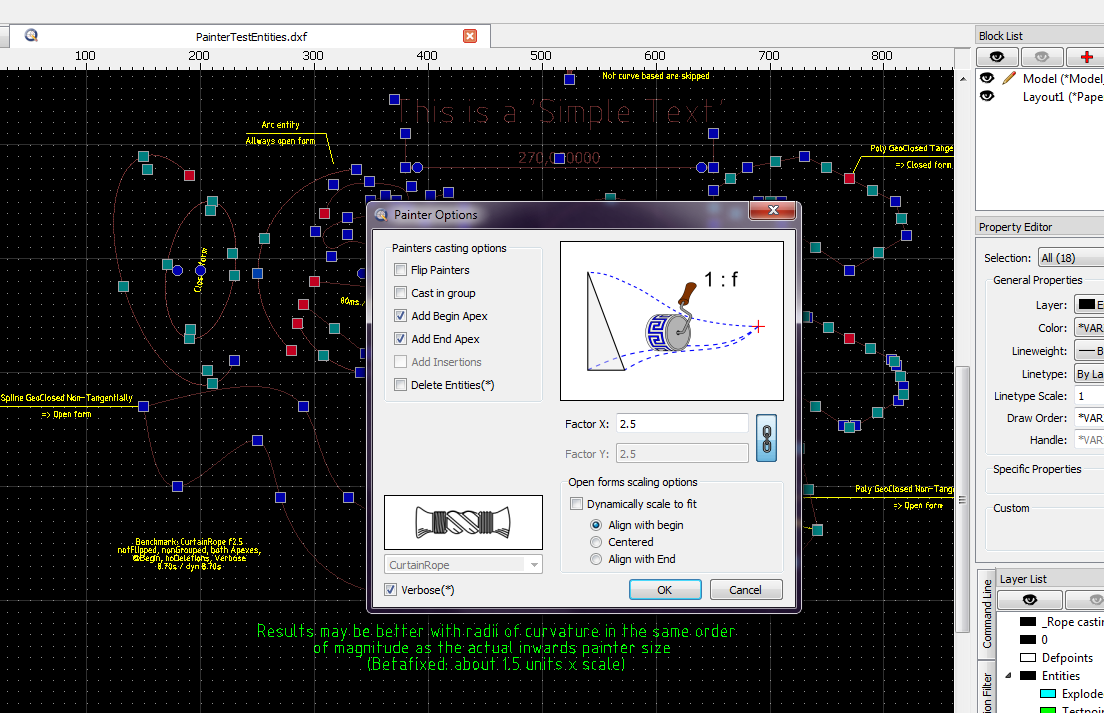

My first hurdle is SIZE.
To have a idea of the actual width....
I was thinking in the way CXF is standarized.
A non-limiting base height of 9 units.
4.5 up & 4.5 down.
Then we could work with actual dimensions instead of a scaler of something hardcoded.
But how will this work out on system or a document not in mm.
The hardcoded stamp is about 3mm high.
(10x actual size on the badges)
On a system in inches the same painter is 3 inch high.
We could keep units for units and only adapt the default scaling on first load to the system/document settings.
Metric then starts with eg. f2.5 and Inches with f 0.1 (same order as 0.09842519...)
Do you have an addressable parameter in scope that tells us what the document it's units are?
With this, I think I can test this route out and perhaps increase the user friendliness.
But that all depends on the yes & no of a circular value conflict.
4.5 up & 4.5 down.
- Posts: 8818
Yes, I think a standard size would probably be the easiest to implement.
doc.getUnit()Class RUnit has some conversion tools:
Andrew, all,
v0.36 now and a little stuck.
The painter width is now base9.
By this the user can choose the actual width.
And it was also possible to let the actual painter length and stepsize to be set individually.
PreserveLook overrides these two and revert back to base9 times a factor dictated by the unchanged width.
On first load reasonable defaults are set.
(Still not sure how to handle doc changes)
On PainterSet change two values are needed: the base9 painter length & the base9 painter stepsize.
These are set by a function FlexPainter.prototype.PainterSetInit(painterSet) part of Flexpainter.js script.
With inserting a multitude of 'debuggers;' and canceling the Dialog every time,
I still could evaluate one widget dialog change functions at a time before the dialog itself terminates.
I'm stuck on the fact that when the on change functions run the data is out off scope.
(This is starting to begin to be the story off my Qcad experience)
I've looked up the use of '.connect' in the master scripts and tried some things out.
I don't get further then declaring copies in the FlexPainter.prototype.initWidgets function.
After declaring they remain static and don't reflect the PainterSet change.
As an on change functions runs the flexpainter functions are also out off scope.

Re: Updated beta 0.40 FlexPainter beta 0.34
Flexpainter Beta v0.40
point4 is in essence a full rewrite of the casting core envelope.
Painters are base9 in analog of the CXF fonts.
Definition width is changed to 9 units, non-restrictive.
The user can choose width, length and stepsize in actual document units.
Aligning is now properly supported, with sub-chains as well globally as locally.
(What was of no issue for the 'CurtainRope' because it is slanted)
Solved the issues with painter definitions situated on the margins.
The problems occured at entity endings of splines and polys.
I'll post a seperate topic on that.
Added several simple but usefull painter sets besides the 'CurtainRope' painter.
These were primarily used for testing.
The sets definitions are still hardcoded in the script file.
One catch however:
I am stuck in the code with selecting painter sets in the Dialog.
Andrew has promised to have a look.
I didn't see any gain in sending him a non functional bunch of code.
It took me a while to have it running and to clean out crap code.
Andrew, I've included a problem description.
For now the workaround is to edit the Flexpainter.js:
Activate the desired set at:
lines 1043-1054
And reboot Qcad, sorry for that.
While you are at it, clean the [FlexPainterOptions] in <QCAD3.ini>.
Changing to units the UI naming stuff changed a bit.
You will get what I mean by this.
At the moment my insights in this matter is basic to none.
The adaptation to different document units is still non existent.
A user that paints 1 inch wide should paint 25.4 wide swapping to a document in mm.
The main casting loop is fully revised and better prepared for future enhancements.
For convience some part is cutted up in little detached if blocks.
What has lead to doubling the same if's, off course.
The pro was that applying rules and methods and the order of became more flexibel.
It will allready support insertions and sub-chains in testfase.
Treatment of painters adapt to:
a) Over-stepped: step > length
b) Box-stepped: step = length (in se !=a and !=c)
c) Under-stepped: length > step eg. slanted: 'CurtainRope'
Set definitions are categorized in intended purpose.
Not limiting that combinations of parameters may alter the actual type & purpose.
Some groundrules had to be aplied:
1) Painter defs are confined within their lenght and start at the leftside.
2) In essence a complete 'painter' is scaled and stepped.
If this 'painter' ends with a void in any way, the void is part of the 'painter'.
Any chain of repeated painters then ends in one such void.
Casting finishes near the end of an entity.
A 'reversed look' is only achieved on a reversed entity, and not by aligning.
For now only splines were used for the artistic look and the natural behaviour.
Straight splines with only two points are merely Line entities.
One thing lead to more and additional datatypes will be added later:
* Point, Line, Arc?, Circle?, Poly, Hatch?
Several pitfalls here:
* Points are used to cast splines globally along the base entity.
* How to morph a Poly, a Hatch?
Allready the points used for global fitpoints were called 'Dots'
And luckily the first four don't need morphing.
Again, much more in detail it can be viewed is the script file itself.
One catch however:
lines 1043-1054
