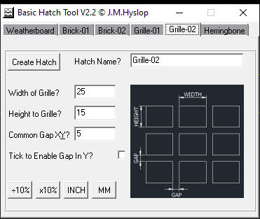

BRICK-02 & GRILLE-02 Now Have
Option to Change Gap in Y
PS. Updates Available LOOK FURTHER ON ;-)

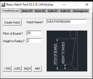

Here’s a New Version of Basic Hatch Tool Available BHT-V2.2
For Community & Professional Versions of QCAD
See Change-Log.txt & BHT-Usage.txt for Details..
Added Herringbone Hatch Pattern Limited to Ratios for the Moment,
This Generally Covers Most Commercial
Plank Sizes Most Use 1:2 , 1:3 , 1:4 , etc

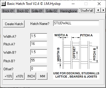

Well 1st of all many thanks to Husky for suggesting the new StudWall Tab :-)
New Version BHT-V2.4.1
BHT-V2.4 Has been Dowloaded 11 Times I've Now Included a PDF
Tutorial on Using The StudWall Tool Now in the zip file and also separately
for those who have already downloaded the Tool, PDF 2 Posts Down
PS Updates Available LOOK FURTHER DOWN
StudWall Tab Added.jpg (55.17 KiB) Viewed 1766256 times

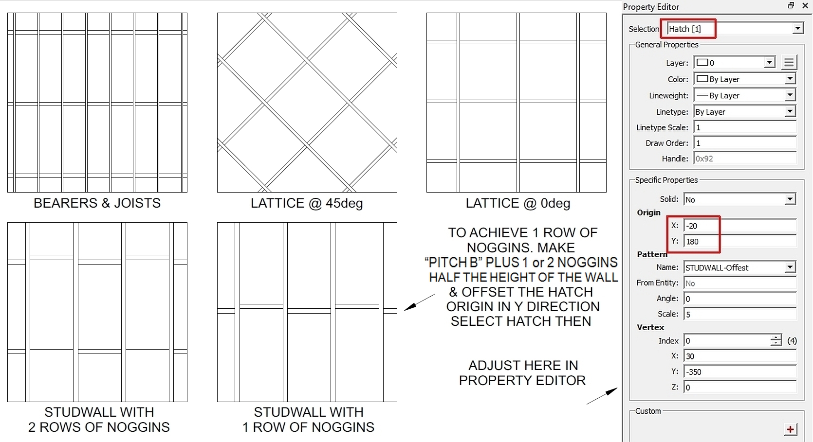

Here are some other things you can make with " Basic Hatch Tool " Hatches
Weatherboard = Decking / Paneled Walls / Flooring / Equally Paced Lines ( Make Radius Half of Pitch )
Brick-01 = Paving / Roof Tiles / Flooring / etc
Brick-02 = Paving / Roof Tiles / Bathroom Tiles / Flooring / Lattice / Decking / etc
Grille-01 = Wire Fences / Paving / Tiles / etc
Grille-02 = Fences / Paving / Tiles / Decking / Flooring / Lattice / etc
Herringbone = Pretty Much as is with limitations at the moment, length must be divisible by width.
StudWall = Decking / Lattice / Bearers & Joists / etc
STUDWALL - EXAMPLES.jpg (358.04 KiB) Viewed 1766167 times
I also adjusted the X & Y Origins to make it fit better in the square box, if the hatch touches the edges of the hatch area you can dimension it to find out how much to move it if required, you can also use keyboard hotkeys IP (Menu> info > distance point to point)
Please Read the BTH-Usage.txt file supplied with Zip, It contains important information about
using the Tool..
Enjoy :-)
Just Updated V2.4 to V2.4.1 Added Message "Incorrect Offset Entered" in StudWall Tab
You can continue to save but it will be incorrect, Just select NO on save and fix incorrect input..
The next version will not give you the option to save if you enter a negative value but
I need to create a subroutine for this on all patterns so I'll fix on next release :-)
PS Just corrected name of PDF file to Studwall instead of SudWall :oops: Oops

Here's a short tutorial on using the StudWall Part of my Basic Hatch Pattern Tool..
I hope this helps, thanks to Husky again for pointing out that some explanations are needed
so people understand how this works... enjoy

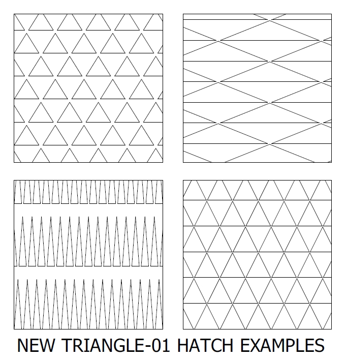

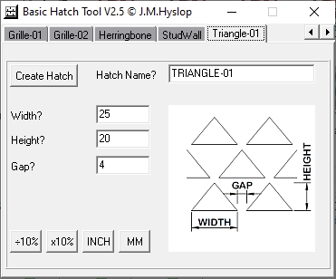

Version 2.5 Available with new Triangle-01 Hatch Pattern
That's a Total of 8 Configurable Hatch Patterns :-)
See examples below:-
And It Holds Reasonable Tolerance at 1 million Units from Datum e_surprised
Enjoy :-)
