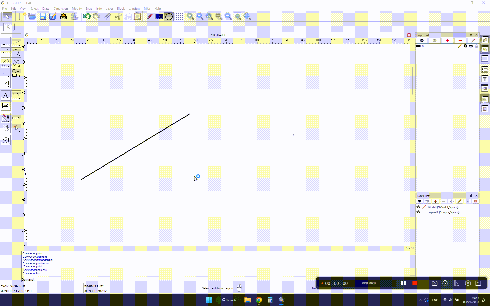

Please see attached.
I try to draw an arc tangent to a line which starts with point 1 and ends with point 2.
It can be done using circletangent2p but then I have to delete the part of circle which I don't need.
Regards
Szymon

- Posts: 5060
Re: Tangent arc
Hi Szymon,
thanks for the demonstration. You convinced at least me that this arc tool would be nice to have.
The right place to post a tool suggestion would be the Bugtracker/Feature Request Forum. It stays there on a "ToDo List" until a decision of implementation is made. Please feel free to fill a Feature Request below www.qcad.org/bugtracker
