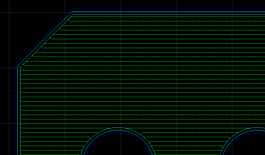

Live test of the Add-On tool: DrawZigzagPocketPath
The tool exploits primarily:
- The QCAD hatching engine
- Generating offsets to a Polyline, a set of Polylines (A Pro resource called RPolygonOffset)
In that lies it strength ... But also its weakness in some cases.
From the above design in '250715_Triac_Module_B_Cu_LaserZigZag.dxf' by user HJ Seef I isolated the required contours.
There was still some work to be done to correctly define the 26 perfectly closed Polylines on layer 'B_CU'.
Then I defined a Hatch with the area to process, the copper to be removed on layer '2) ...'
A copy of that Hatch was fed into DrawZigzagPocketPath and the results can be found in the attached file on layer '3) ...'
250715_Triac_Module-ZigZagTest.dxf
(2.96 MiB) Downloaded 7 times
Green: Zig-Zag tool paths, Cyan: Finishing passes, Blue: Original contours.
I must add that the needed parameters are quite harsh, the working Hatch has 11,336 line segments to be merged.
The total length of the trajectories is over 75 meters for a PCB not larger than 78 by 124mm.
Even at FEED 1000mm/min that would take over an hour not accounting declarations at reversals.
What I could have expected for this test:
  • Pattern stability should be rigorous by default.
    The Hatching engine may simply time out => Maxed out this preference to 10,000ms, 10s and more is possible.
    New is the complexity threshold in recent releases.
    It is rare, but not unknown, for the hatch engine to fail partially.
  • Offsetting any arbitrary set of Polylines is, as is well known, not always guaranteed to be flawless.
    Said to be an issue of small values from small shapes (Arcs), the number system and not complying with fixed internal tolerances.
    The solution is typically found in scaling the source up and scaling the results back down.
    In such a case we must adapt the Add-On tool options accordingly.
Noting the Hatch engine flaws documented for layers 'X) ...' and 'XX) ...' I can conclude that the live test went well. :P
Well but not error free, the Add-On didn't invent those errors in the export.
These were most probably generated by the Hatching engine.
Offsetting these 25 contours was no problem, on purpose each limited to a single offset to all 25 Polylines at once.

Did the same test but now angled at 22.5 degrees.
12257 Hatch-segments merged to 64 Zig-Zag paths.
More chains but all in all a fraction shorter.
This time it took about 19 minutes to generate the export.
Some time factors are:
- Waiting on the Hatching engine, time-out is maxed out at 10s (Longer is possible).
- Waiting on RPolygonOffset results, about 8-9s per call for the set of 25 Polylines.
- In between rigorous testing, eventually with warnings of the unexpected, not expecting everything to be as expected.
- (Fast) C++ resources that return the unexpected circumvented by JS code.
- With some tweaks it runs on QCAD 3.32.4 just the same as on QCAD 3.26.7 (Scripting is not backwards compatible, nor forward).
:arrow: The most important note: Error free :P
And that all in a single click :!:
