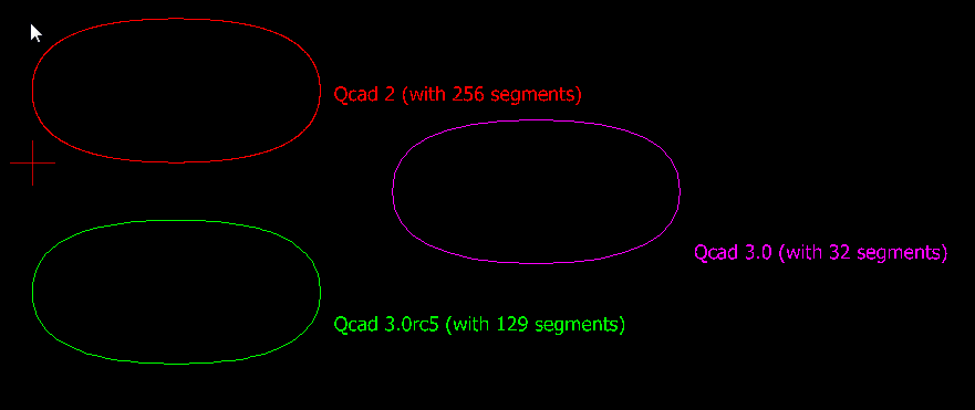

Yes I completely understand, I do a lot of laser cutting and the importance of absolute accuracy is vital in most/all jobs.
Agreed there is a very big difference between the number of segments using version 2 and version 3 final (see snapshot).
I`m sure Andrew will 'pick' up on this and provide an answer/solution regarding the feature request:
