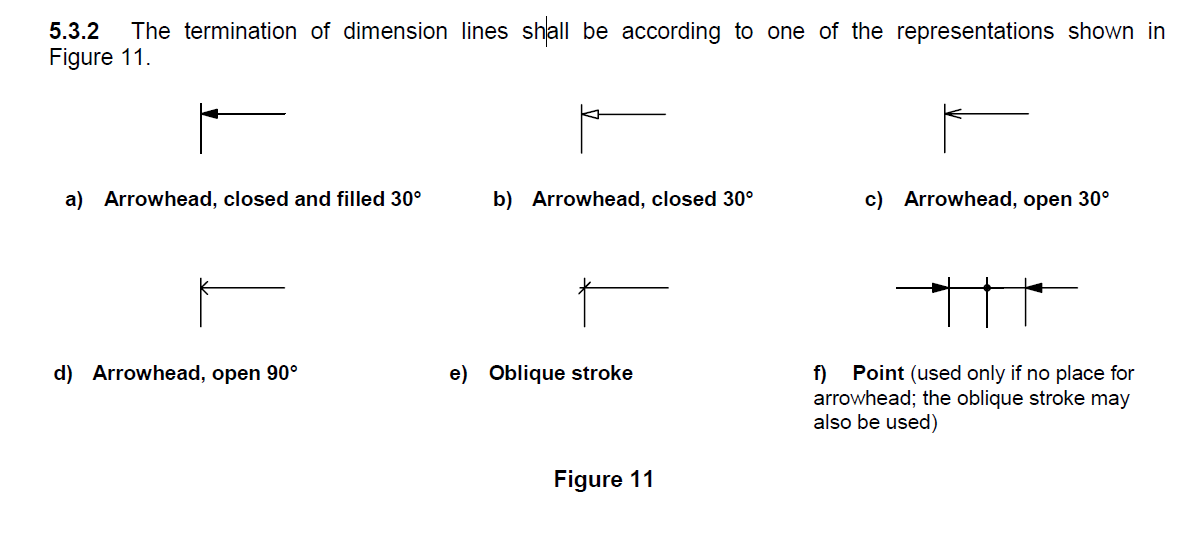

Afternoon,
As I mentioned in my introduction, I trained in technical drawing in the pre-computer era. This is probably why I developed a preference for open arrows, rather than the closed and filled style. As far as I know, there are still a variety of arrow styles allowed in the ISO standards, and it would be great if we had some more options in QCAD.
Of all these options, we only have the filled arrow and the oblique stroke. It's be lovely to have the full range.
This isn't an issue which prevents QCAD from doing it's job, it's purely a preference issue which would make it more 'comfy', for want of a better word. Hopefully it is so simple to implement it might be considered. :D

I was fully aware that it isn't a high priority, but I think it fell squarely in the category of "If you don't ask, you don't get.." :)
I can see how it might be considered a feature to accommodate 'a few', but another way of looking at it is that it makes this functionality fully ISO compliant, which has to be a good thing for everybody.
It actually highlights another very minor difference I hadn't noticed earlier. You mentioned a 3:1 ratio for the arrowhead; where the ISO standard I have has the arrowhead the same length as the height of the text, and with a 30 degree angle, which would make the ratio pretty much 2:1.
Of course in the days of paper and pencil, arrowheads just had to be neat and clear. I was told to draw them 2mm long, though I'm pretty sure that if they looked about right, no-one ever measured the size or angles of them. :D
Thanks for highlighting options in the DXF standards for alternative blocks for arrowheads. I'll maybe investigate those at some point, but right now I think I shall leave that alone because I'm not really much good at scripting beyond fairly basic tasks.
In DXF the text height and the arrow length are unrelated.
To be correct the QCAD ratio is almost 3:1 ... 18.9246°, for some reason it always turns out to be 18.9076° :roll:
And after I looked it up, it does match perfectly.
The half arrow is considered to be 0.165 rad, times two is 0.33 rad and that is 18.9076072.. degrees.

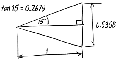

I'm sure the QCAD ratio is right for a 3:1 dimension arrow. I'm just a bit puzzled. I haven't worked much with the .dxf format, but is it the dxf format itself which controls the dimension arrows? I'm struggling to accept the notion that the most common format for technical drawings can't easily do arrows which follow the ISO conventions.
Any idea where the 3:1 arrow originates from? A particular field (general technical, mechanical engineering, shipbuilding.. etc?) or a geographic region? Or just some random programmer at Autodesk..?
Mon May 22, 2023 11:06 pm
To make it 30 degrees the half arrow should be PI/12 or about 0.2618 rad.
I am not aware if this is intentionally or by mistake/misinterpretation. :wink:
Pretty much 2:1, I agree, but in my book that is equal to 28.072487°. :wink:
- Yeah, to get a total 30 degree angle, the arrowhead should be treated not as one isosceles triangle ,but two right angled ones, with an angle of 15degrees at the point. Sin(15) is 0.2588, which doubled is 0.5176; so not quite half the length, but to be fair, I did say "pretty much 2:1". :D
Not sure where you get the Sin(15) from ... 15 degrees is 0.2617993.. rad, 30 degrees is 0.5235987.. rad, ... Ok 1/0.5176 is about 2:1 ... :wink:
It is treated as two right angled triangles.
- Oh that's easy. It was late, and my brain grabbed onto sin30 as a quick approximation because I know that sin30 is 0.5. Then when I meant to work it out properly, I never noticed that my initial quick guess was fundamentally flawed. Here's my proper workings out to prove I'm not a complete moron... LOL
So. 0.5358. Still close(ish) to 2:1 ;)
