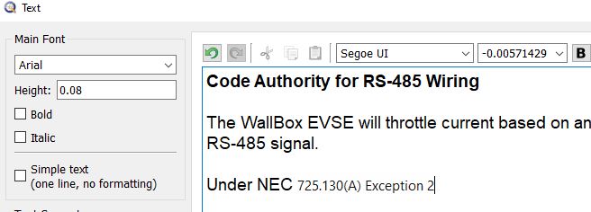

Could you add "plain text paste" as ctrl-shift-V
Why? Because sometimes the clipboard comes in with rich text formatting that's anti-helpful.
The workaround is to paste into a plain text editor, or the console, then recopy and repaste into qCad.
One could also argue that qCad should NEVER take rich text, and rather only accept the plain text.
Either way the ctrl-shift-V shortcut is useful for those trained on other software.

I still can't paste in plain text mode to the QCAD Text Editor widget.
One of the source I often use is copying text from the Command Line history, especially results from the info tools.
These are handle by EAction.handleUserInfo(...) and are in color #0066cc by default.
After selecting a portion of text one can not copy that with Ctrl-C but one can use the context menu: R-Click .. Copy.
Ctrl-V, Shift-Insert and context menu .. Paste are all in Rich text, Ctrl-Shift-V is not functional in the QCAD Text Editor.
It is thus not the question of 'reinvent the wheel again', it is a question of implementing an extra context menu method to strip formatting.
Or to support Ctrl-Shift-V in the QCAD Text Editor and deprecate this shortcut for PE.
The work around is to set your text to simple or edit the source of your text directly.
Still, pasting plain text for the latter it will be formatted in a last active format what is intended behavior.
Editing the source of formatted text can be tricky.

Try to choose "simple text" option, paste and then, unchoose "simple text option. That's what I do...

Your method is indeed a work arround also mentioned a few posts up (p44022) :wink:
The catch is that inserting text into an inline formatted Rich text string will use the currently active formatting at that point.
Rich text formatting is typically a prefix but there is no suffix included to turn things back to normal.
Fiddling in the text source to get it right can be tricky.
As example: Setting only some words of a long text in another color.
Pasting plain text would also ensure that the main text settings and the default color are used.

- Editing inline formatting does not always result in the expected.
For example highlighting parts in a different color, close, re-edit, close.
- Multi language support ... We need to strip formatting codes and not merely isolate text based on 'ABC123'.
- Source related inline formatting or Rich Text of any kind and I have no overview of all possible codes.
Jose Vieira solution was too simplistic but triggered another issue:
- Pasting stripped plain text is not always the solution, it might that we need to paste an inline formatted text ...
... Overriding current active formatting at the spot where we insert + Re-activating the former active formatting after the snippet.
- It is then or just paste as plain and keep current active formatting, or paste as plain and also enforce global formatting by dialog.
So yes, it can be not that easy.
