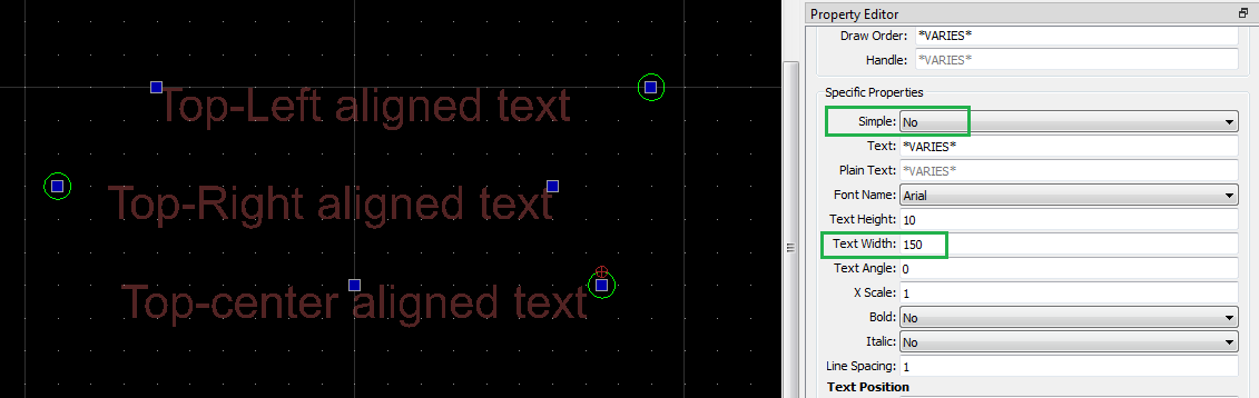

Jose Vieira wrote:
Sun May 04, 2025 10:33 pm
But this - "This marker is the left one of two when the text is aligned to the right, otherwise it is the right one" - is not working.
Simple text is all on one line.
For text in Columns it must be set to not simple text.
Encircled are the text width markers opposite of the normal insertion markers.
150 to right, 150 to the left or 75 to the right of the standard text marker.
