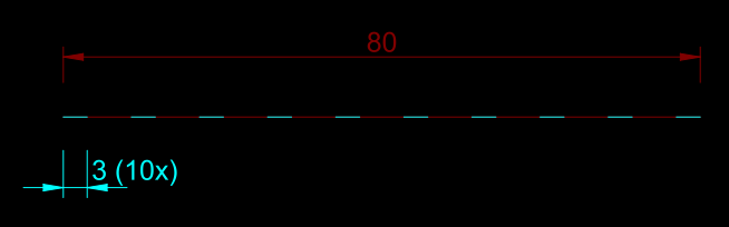

Hi Clive,
do you need something like this?

Nearly , try pasting a line 3mm long horizontally along another horizontal line of 80mm long.Husky wrote:Hi Clive,do you need something like this?
The result I'm looking for needs to be that the 3mm line is pasted along the 80mm line evenly and with even spaces in between!

Ok, understood and I don't see any easy solution (without a manual calculation) to complete this task within QCAD.Clive wrote:Nearly , try pasting a line 3mm long horizontally along another horizontal line of 80mm long.Husky wrote:Hi Clive,do you need something like this?
And yes, would be nice to have a tool for this ... I could use it too ...

Draw a horizontal line of 80 mm, place on it at the left end a 3 mm line, select the 3 mm line, launch Move/Copy, Reference left end of the 3 mm, 9 copy's, Target point relative at @(80-(3*10))/9+3,0 = task accomplished!
