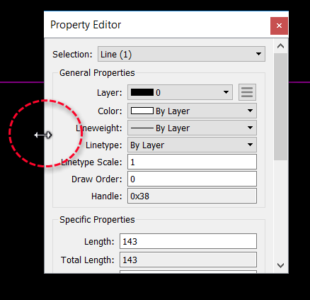

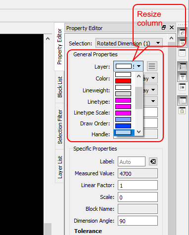

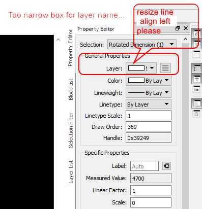

The line for "General properties", "Layer" the line is too narrow, so you do not see the layer name when the Property Editor is pinned to the side.
(see attachments below):
Can the line be extended (for example, align left)?

cqman wrote:The line for "General properties", "Layer" the line is too narrow,
use a "left click and hold" action on the left border on your Widget (Property Editor) and pull the width to what ever fits your needs.

I'm afraid, the suggested way is not the best solution if we want to keep the small side panel width.
More efficient would be to edit script files:
...\scripts\Widgets\PropertyEditor\PropertyEditor.js
...\scripts\Widgets\PropertyEditor\PropertyEditor.ui
and parameters
<property name="alignment">
<set>Qt::AlignRight|Qt::AlignTrailing|Qt::AlignVCenter</set>
Note "AlingLeft" is missing?
<property name="minimumSize">
<size> <width>50</width>
But I do not have enough experience to interfere with the script
so as not to completely change the appearance of the dialogue.
