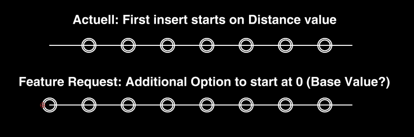

Yes, thank you very much, but ...
I can ask for more. :D
When creating a bank it would help to place objects with an Offset (see attached example).
