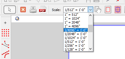

Out of Model_Space Print Preview presents drop down defaults in imperial scales - nice but also expected.
But, scrolling down the list shows scales like 1/4096" = 1'-0". I've never seen those scales in the real world. Just think about this scale - it tells you that 0.000244140625" is equal to 1' ... who works with a scale like that?
BTW - it doesn't looks better converted to metric mm 0.006201171748 mm is equal to 304.8 mm :shock:

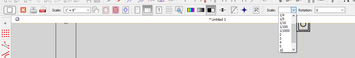

Printing in Paper_Space ...

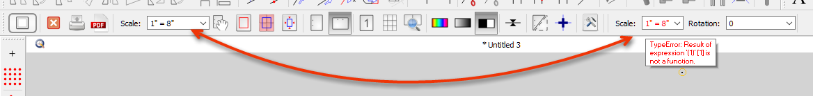

If I add a Viewport the print tools pop up. First Scale option should be the same like that one in Print Preview - but the drop down list is gone - just a metric scale of 1:1 shows up. At least it accepts a manual imperial input like 1" = 8". The other scale option in the tool bar is for the Viewport. Yes, a scale list will be presented but now it's a metric list.
Im pretty sure no one of us will ever work with a metric and an imperial scale in the same drawing! However, smarty pants me - I type in the imperial scale which is immediately declined with the message: "Type error" occurred. Nope, it wasn't a type error the field just doesn't accepts imperial scale formats ...
... but it accepts metric 1/10.

Is the lack of pre-populated common imperial scale options such as 1/4" = 1' in the viewport scale field simply a matter of it not being implemented, or is there more of a purposeful reason for it's omission here? I would think this would be the primary place where someone would choose their scale when placing a viewport in paperspace, so having those common options to choose from like they're already available in print preview would make sense, at least to me. I know with my students last semester, we'd be dealing with 1/4" = 1' or 1/8" = 1' but when they'd place a viewport, they'd have to enter it as 1/48 or 1/96. Of course that's not a big deal at all but I wondered if that is an intentional decision that makes sense beyond my limited knowledge?
Re: Printing with imperial scales
Posted: Wed Mar 23, 2022 9:08 am
Yes, this is simply not implemented. I will look into improving this.
No idea. I've never had the pleasure to work with imperial scales, so a bit of help would certainly be appreciated with a list of "acceptable" or "common" scales in the imperial world. Frankly, to me 1/8" = 1'-0" is just as exotic and unthinkable to work with. These scales were suggested at one point by other users.

In the print preview scale drop-down, I see that this extends all the way down to 1/4096" = 1'. Perhaps those much smaller scales are used for GIS/mapping purposes? I have no experience in that area so I have no idea if those are actually used.
For anything scaled up larger than real-life size, I have only ever seen those scales listed with a unitless ratio such as 2:1, 10:1, etc, since we're typically talking about an engineering/mechanical type drawing which is almost always in Metric.
I'm not sure about the use-case for the scales from 1" = 2" all the way to 1" = 4096" that are in the print preview drop-down, but who knows?!
I think something went wrong with this funky scale. Let just remember why scale information are used on a drawing. It is a way for who ever human reads this drawing in the field to compare drawing measurements to real world measurements. If I use an Architecture triangle ruler in the field I can easily read what is covered for e.g. 1/8 of an inch. If I have a scale of 1/8" = 1' then I know the measurement of 1/8" represents 1'. Easy peasy, ...
Let's use common sense: How to read on an Architecture triangle ruler a 1/4096 of an inch to figure out what is a feet in length in the real world ... :wink:
(For the metric guys ... we are talking about 1:49152).
