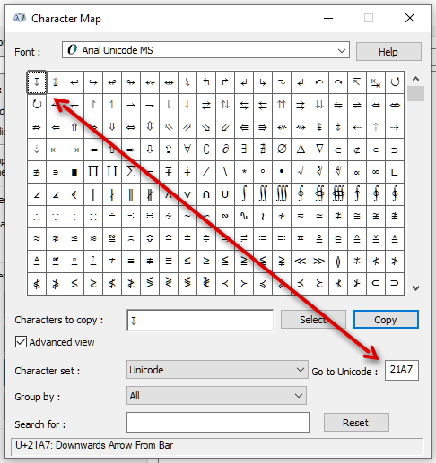

nope - not with the current used Character Map in QCAD. It looks to me that QCAD uses a QT Character Map.
However - Unicode in Windows is a closed book. They work on different ways in different programs. A few programs need a different code format and a few programs don't accept Unicode at all.
This said - the Windows Character Map is a bit more advanced. By a bit I mean a bit! But it has a search field what can help to speed things up. You can use the Win Character Map but it takes one click more (Copy/Paste) than the QCAD Character Map. :wink:
It will work with the QCAD Text Editor

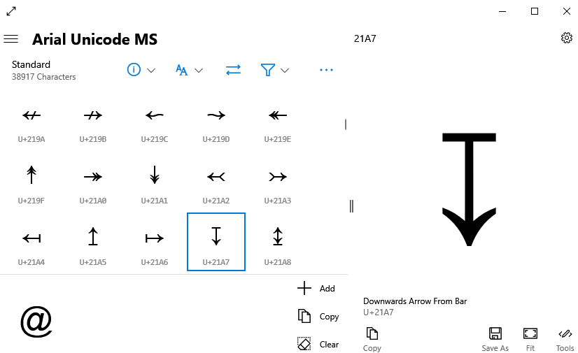

Windows has also a fancy Character Map called Character Map UWP.
Well, I should clarify: A bit more fancy but still not good enough. BTW - It doesn't works in QCAD Text Editor but in Property Editor etc. etc.
