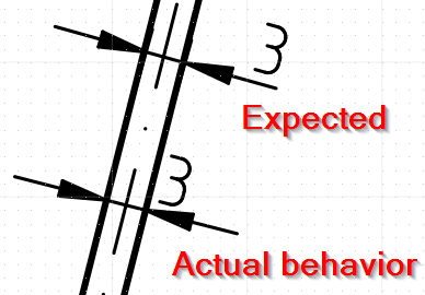

is it possible to setup QCAD to position the dimension number not over the arrow but rather over the leader line?
Like this:
Not that I know, but you can edit a dimension and drag the text to wherever you want.

Isn't the current way invalid though? From the standardization perspective, i think it is. I just checked with ISO 129-1 and it says:
5.6.3 a) dimensional values can be above the extension of the dimension line beyond one of the terminators, if
space is limited (see Figure 25);

So when we need the dimension number be displayed in the outside, we also need to add the extension line manually to have it reach the end of the dimension number in case it is longer than the dimension arrow. This feels very lengthy.. Maybe i should try proposing this to be implemented in the relevant forum section?
Dxf supports auto lengthening the 'Leader' side.
