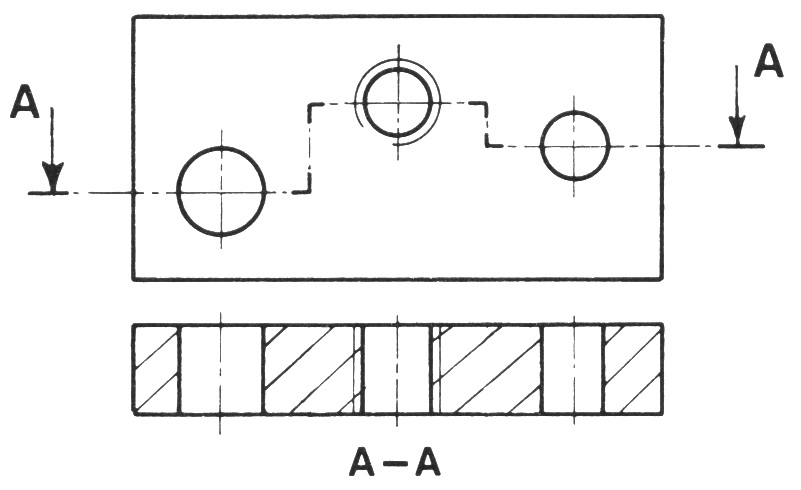

What's the best way to create (as a single block, rather than collection of lines and text) cutting plane lines and letters
as shown on top half of attached sketch (A-A).
The only way I can think of doing it is by creating a block?
but is there a better way, please?
Figure 1.PNG (74.22 KiB) Viewed 3671 times

bambuko wrote:
Fri Feb 03, 2023 2:50 pm
Yep, the only way of grouping things under QCAD.
Groups of entities are not supported.
... as shown on top half of attached sketch (A-A).
Just for the records - I don't see the need for a cutting plan on this example. Just a Front view would give all needed information.
Me too. I work with blocks and Attributes.
Cutting plane.gif (1.48 MiB) Viewed 3612 times
Maybe someone else in the forum knows a better way ... :oops:

Post by bambuko » Sat Feb 04, 2023 11:03 am
Thank you for the confirmation guys.
I thought it was the case. but it is always better to ask... :wink:
