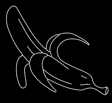

The PDF file contains a single bitmap (an image defined by pixels) in a format that is currently not supported by QCAD. Even if QCAD could import the image, you would be left with an image, no vector data (i.e. no lines, arcs, etc.).
You might want to consider other sources for your images, for example thenounproject.com which offers SVG downloads of similar type.
SVG files contain vector graphics, so they can easily be turned into DXF, G-Code, etc. QCAD can open and import SVG files.
Another possibility is to vectorize such a bitmap with Inkscape or QCAD. The result of such a vectorization with QCAD is attached.
banana.dxf
(124.42 KiB) Downloaded 397 times

Looking at that dxf file, it's not as clean as the original line drawing. I've spend the last hour trying to get somewhere in inkscape...

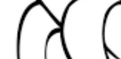

testriderchuck wrote:
Fri Apr 21, 2023 9:21 pm
"It's a simple line drawing" she said
"How hard can it be?" she said
Well, bitmaps as these usually originated from simple line-art.
To represent lines and especially slanted or curved lines and/or the stroke width the bitmap uses shades of gray.
Have a look at it at 500%:
The bitmap looks OK for us humans ... on a screen ... in the intended scale.
But it remains a (poor) representation.
For a computer it is merely a vast amount of pixels in all kinds of gray.
The way back to line-art is less straightforward and data compression doesn't help in that case.
To be exact you need the inverse mathematical approach of how the line-art is rendered as pixels.
And that will never be readily available.
There are many tools out there that do a throw at this, some already better than others.
Inkscape is one example but the bitmap tracing result depends on the used settings.
Center-line tracing will remove any stroke width.
- In QCAD/CAM that would result in a uniform carving with the used mill diameter.
Line-art with stroke width is yet another story.
- One can not represent that very well in DXF, polylines with widths are an option but that is still a center-line for QCAD/CAM.
Edge detection will try to draw an (hard) outline.
- QCAD/CAM doesn't support pocketing out of the box, aka filling the outlines.
So it is basically a question of the source file.
