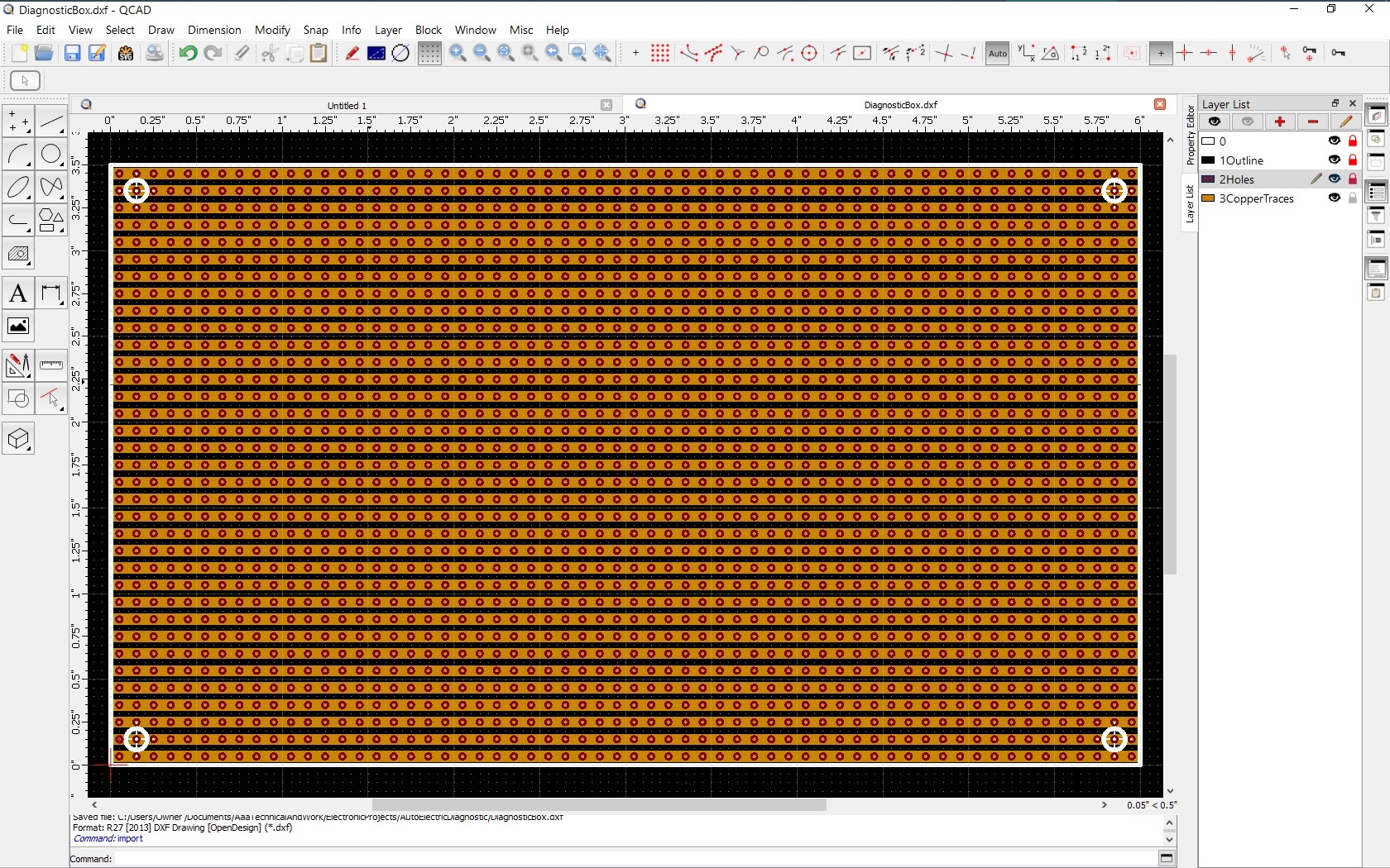

Not completely sure how I drew that original rectangle. I thought I select Rectangle with dimensions and typed in 3.5 and 6. I did have the units set to inches. But I must have done something wrong.
The new outline is OK and I am making progress. Screen shot attached.

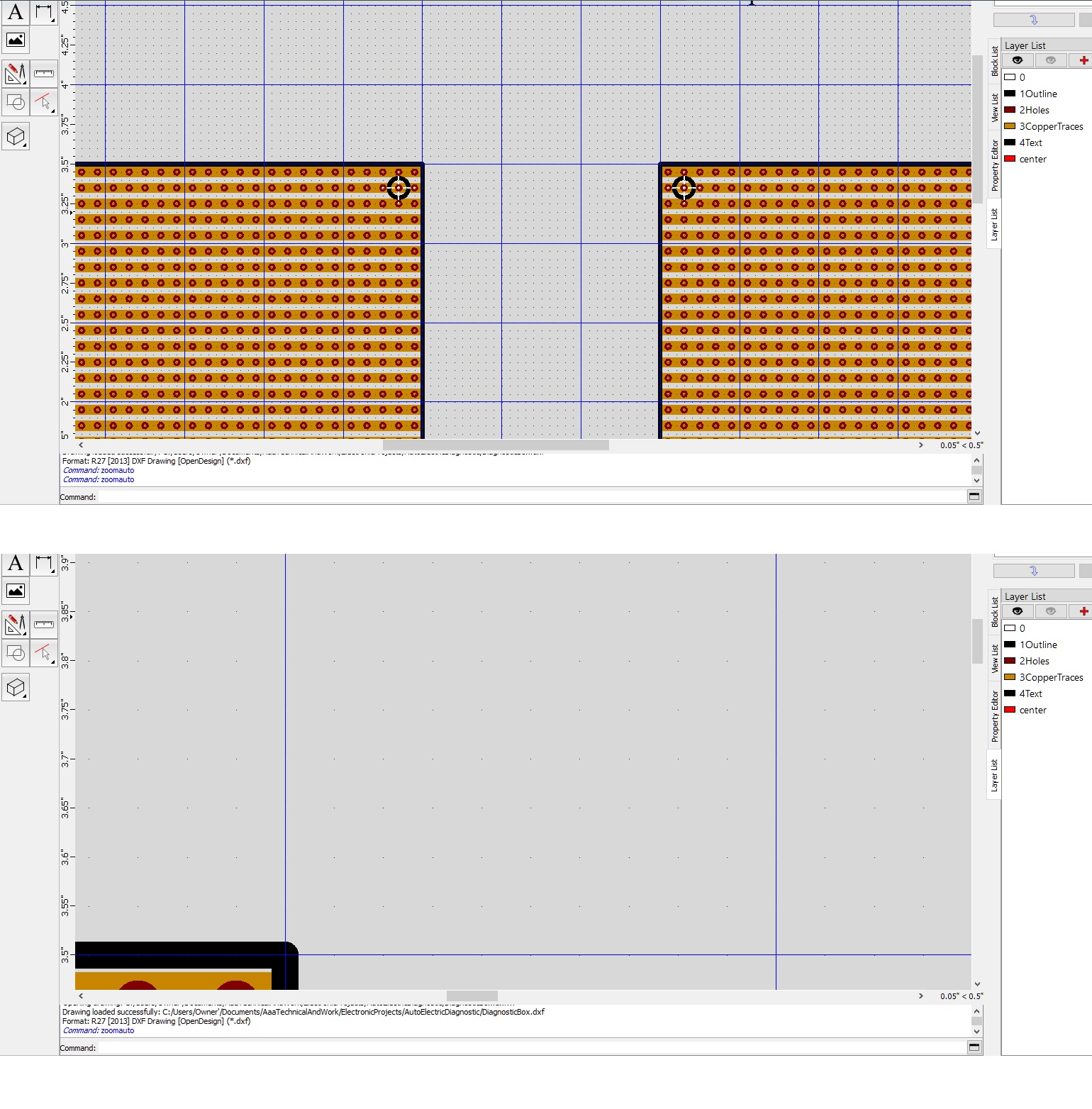

Post by Chips&Chips » Thu Feb 08, 2024 12:02 pm
It was late and I was tired. Yes, I did mean zoom IN.
I start with Imperial, and Inch units for both Drawing and Page units.
I set the Grid to 0.05" for both X and Y.
I set the Meta Grid to 0.5" for both X and Y.
My screen view covers about 7" wide by 4" high.
And I can see the Grid dots and the Mega Grid (lines by my choice).
THEN I zoom IN.
The Grid dots and Mega Grid lines become wider spaced.
I zoom IN more and the Mega Grid lines stay very nicely visible.
BUT the Grid dots become less and less visible with every click of the mouse wheel.
And at some point the Grid dots become totally invisible.
I have tried a number of background and Grid dot colors but always the same. The Grid dots disappear.
OK, I took some screen shots and blew them up. And the Grid dots were there. Just too small to be seen. I need to look at this some more. It's late again so, tomorrow.

Perhaps just an illusion? Grid dots are more visible when close together than when far apart.
Can you compare two grid dots from two screenshots (zoomed in and zoomed out).

When you set certain values for Grid and Meta Grid then these values are also considered to be a minimum.
This minimum setting counts for automatic scaled or not.
If we zoom in far enough then a single grid step can exceed a screen height and/or width.
At best there will be 1 Grid dot (or a single crossing pair of lines) but chances are that all is outside the visual viewport.
About visibility:
A Grid dot is the same thing in the same color in any zoom state.
Like Andrew said probably an optical illusion.

I have played around with this some more today and I have confirmed that the Grid dots do remain the same size and color at different (all?) magnifications. At least until they do get too close together and then disappear. So yes, it probably was an optical illusion. It is a fact that there are fewer color sensors in the human eye than luminance (black and white) sensors. So a color with a similar luminance level can disappear when it becomes too small. And apparently this can work even when the luminance levels are fairly different. Here is the comparison photo pair I was going to say is evidence of the disappearance. But, when I zoomed in while putting them together in Paint, the dots were there and exactly the same color and size, in pixels. This is why we need settings for something like a grid.
I don't know if my observation can be verified with the jpeg image allowed by the BB software. But, as I said, the dots ARE still there in the second captured image.
I really don't like the black background. I am trying to develop a color scheme with the gray seen in my screen shots. I had an idea while trying to sleep last night. A Grid with full lines instead of dots and a color that is close to but slightly darker than the background color might work better. After some experimentation I found a custom gray color that seems to work. You can see this in the screen shot below.
But the Meta Grid is still problematic. I tried a number of colors and all of them seemed to be either the same as the Grid color or close enough to it to be invisible. This changed as I zoomed IN and OUT. I finally selected black because it is as far from the light gray background color I selected as possible. But even that was still troublesome. Then I zoomed out and saw the above. There seems to be some kind of periodic interaction between the Grid lines and Meta Grid lines. And the period appears to be different in the X and Y directions. This periodic variation in the Meta Grid was not visible when I was using dots instead of lines for the Grid. That's why I suspect an interaction between them.
Is this effect due to something in QCAD or is it my monitor? I can say that I have not seen it in any other CAD program that I have used in the past 30 years or so.

This Is most likely a screen effect and so far I can see the periodic nature is about 6'-8" in both X & Y speaking in 100% viewport terms.
It has to do with your screen DPI and if the horizontal or vertical line falls perfectly on a pixel or not.
Seeing a series of dots better than a few isolated dots has less to do with the capabilities of the eyes but more with the gray matter between the ears. Our eyes are fairly blind for details and also for the bigger picture but our mind is very capable in detecting/seeing patterns but also in inventing them. What we think what is our visual scope is actually a collage of hopefully more real parts than imaginary.
But tests have proved big time that we are fairly blind for things that we don't expect to be there and invent those we expect.
For me the dots in the lower example of HereYouSeeThenAndHereYouDont.jpg are perfectly visible.
I see the same wavy nature for the dots in the upper example as previewed on the Forum.
But when I open the image in a new browser tab at 100% the wavy nature is gone and all pixels have the same pronounced color.
