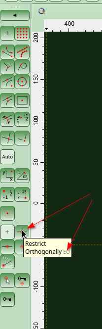

3: Yes, you can. While in a command like Line, type EO to continue drawing orthogonal lines.
Tip: While moving the mouse in the direction you want, hit the spacebar — this activates the command line. You can then just type the length you want for the line [then Enter] Pressing the escape twice gets you out of octagonal mode.Also see image below:-

Restrict orthogonal (EO) is indeed reset after canceling a drawing tool, similar to most other snapping options.
You can lock these options using Lock Snap (SQ).
As John explained there is the option of 'Direct Distance Entry'.
But you could also hold down the Alt key to restrict orthogonal when indicating a new coordinate input.
