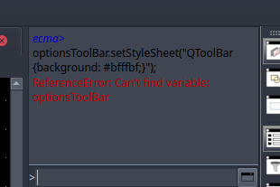

4. I'll check out PeteVick's tool, but I have further understood why this is even an issue for me. I've attached some images to show how bad the text colors render on my side. The reason is because of the KDE theme I have installed (breeze dark). It doesn't seem very compatible with QCAD.
I'm currently trying with other dark global themes in order to choose a better one, otherwise I'll try PeteVick's theme designer to tweak mine.

Post by faraggi » Wed Oct 15, 2025 11:16 am
The attached screenshots with different KDE global themes.

Post by CVH » Wed Oct 15, 2025 2:31 pm
I can read most of the text in your screen captures without any problem ...
... Perhaps the brightness of my screen is set higher ... :wink:
Blue on very dark grey is indeed less ideal but that is the command you just started.
Black on very dark grey for the Script Shell dialog is probably an issue. :o
I see a ReferenceError popping up in the Script Shell dialog.
optionsToolBar is a variable, the omitted first line of the tweaking code loads a pointer to this widget in the variable.
A HTML color code are 3 bytes, 1 byte for red, 1 for green and a third one for blue.
The hexadecimal notation for a byte has 2 digits ... 6 digits in total.
In "#bfffbf" there is one "f" too many. :wink:
