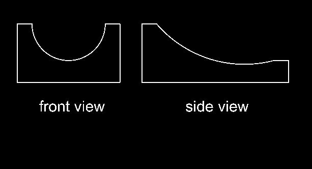

Sure: the top and side view were drafted as usual with the QCAD 2D tools. the '3D' view is an isometric projection which was created from the front and side view with the isometric projection tool of QCAD.
Implies that an isometric view can be created from a front and side view of an object. Do the front+side views have to be created in a special way? How are the tools used please.

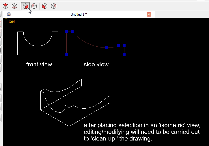

To use the 'Isometric Projection' tool - front, side or top views would be drawn in the normal way (no special methods etc...) then simply select all or part of a view (or any single entity, object for that matter) from your drawing and follow the prompts in the status bar. 1. Select for example side view (see snap shot).
2. Select reference point.
3. From the 'isometric' options (top,bottom,front,right etc.) select the isometric plane you wish to use (my example = right).
4. Place your selection.
5. Clean-up your drawing with the edit/modify tools etc... * Note: I believe there will be an isometric grid option added sometime in the future - to switch between orthographic and isometric grids. This will help 'big time'
when needing to draw an isometric view!
Hope this explains and helps for now.

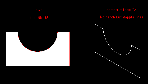

I have a question to this topic ....
Based on your drawing: If I use this shape with a solid hatch, put this into a block and try to create an isometric I will get an Isometric without the hatch but with double lines.
Is that how it should be? Why is the hatch lost but I have still the double lines from the hatch contour? It works fine without a block .....

Thanks for your effort but that is not the problem. My problem is based in the "Block isometric scenario" with a result of "No hatch but double lines".
Re: How do I use the Isometric Tool?
Agreed - I see what you are saying now
Workaround
Explode the block to release all the 'control' points then use the iso tool to move the outline and hatching into an isometric projection.
Its not ideal but it works for now.
