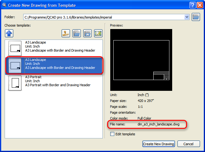

Post by Husky » Thu Jul 25, 2013 7:37 pm
I have noticed that it must be possible to define a Template Name - different to the Filename:
How can I do that?
Clive
Posts: 1329
Location: UK
Re: Name for Templates ....
Post by Clive » Tue Jul 30, 2013 10:34 am
The short answer is I'm not sure :( ,I have tried but can't find a way.
But I think we should have an option in the 'Save as' dialog to save any drawing (including an existing template) to a dwt (drawing template) where we can choose our own template name and destination :wink: .
A feature request is needed 8).
EDIT: Feature request added:
http://www.qcad.org/bugtracker/index.ph ... ask_id=868
