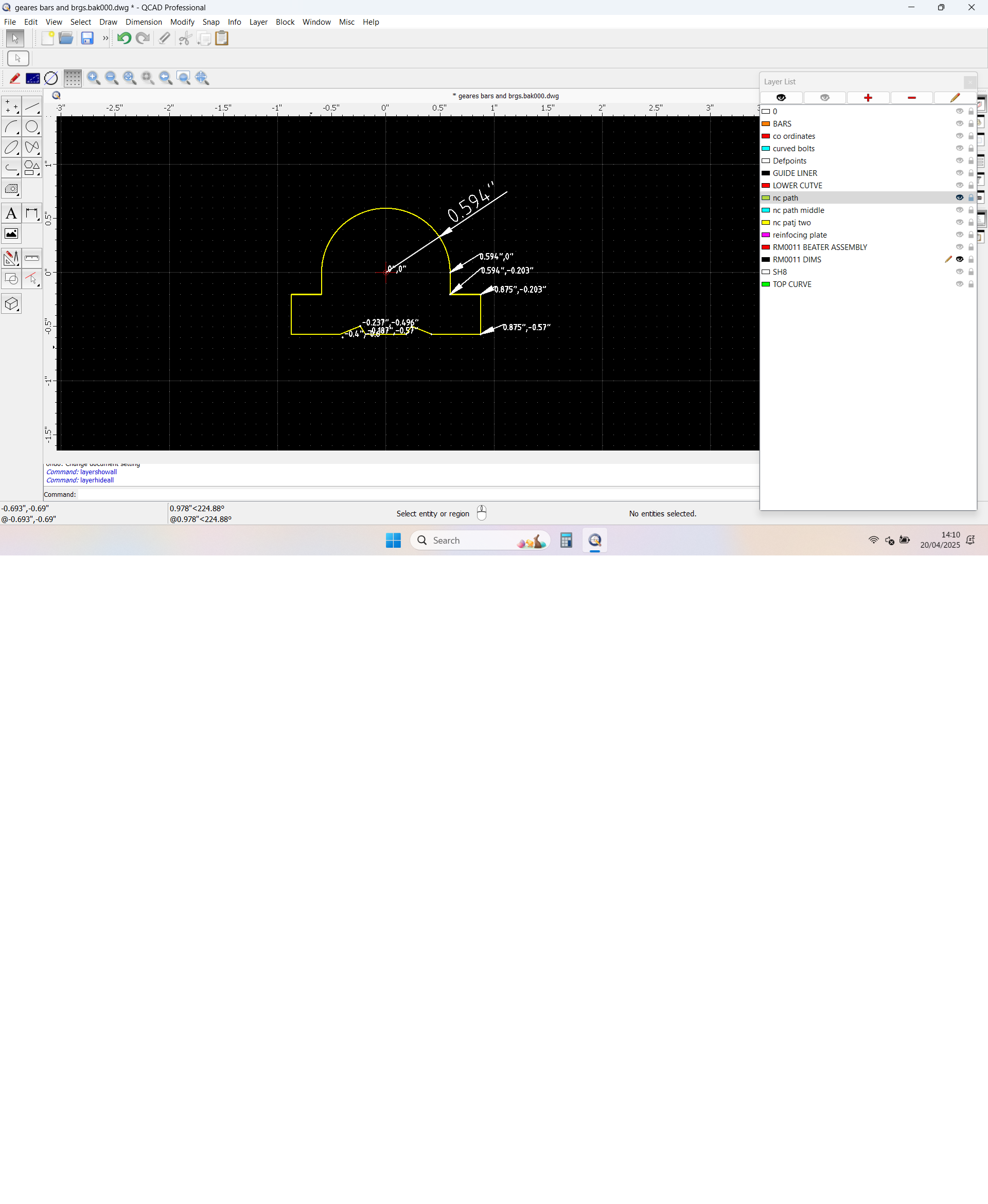

CO ORDINATES.png (284.84 KiB) Viewed 13229 times
I understand complexities in the program.
I attach what I wanted to achieve.
The r/h side of the drawing is with the 3 commands the bottom jumble is using
IO only.
The co ordinates will be used to manually write a Mach 3 CBC program on another computer hence I need a transferable copy.
My work! is hobby based so time is not critical and I will take the matter as closed.
Thank you for your insight.
Graham
