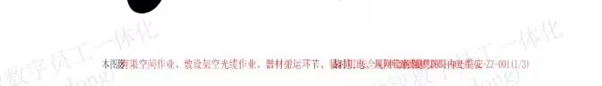

When Qcad is on the CentOS system and QCAD is called to convert to PDF in CentOS, how does the resulting PDF automatically break lines?
yyj
Posts: 3
Joined: Tue Dec 16, 2025 7:41 am
Re: Does Qcad support automatic line wrapping?
Post by yyj » Tue Dec 16, 2025 9:08 am
Just like the image I attached below, such a long sentence doesn't wrap itself, so I need to implement automatic line wrapping when implementing this feature, so that I can print out every line of text when converting PDF. Thank you
Posts: 8847
Post by andrew » Tue Dec 16, 2025 9:20 am
If the text entity in the DXF or DWG file has its text width set to non-zero, the text is automatically wrapped at or after the given width at the next space.
Note that this will not work for Chinese as if I understand this correctly, Chinese generally does not use spaces between words.
I'm afraid QCAD does not support automatic text wrapping for Chinese and other Asian languages that do not use spaces.
