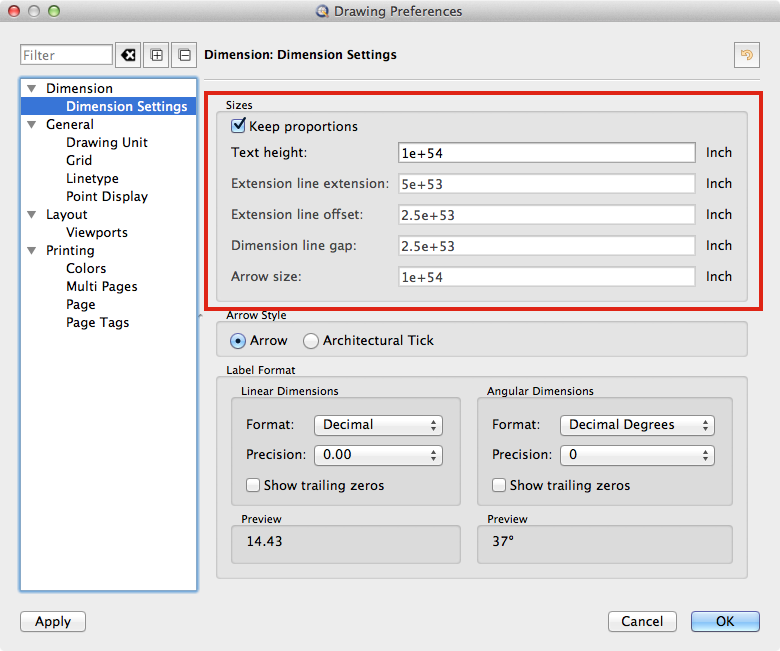

Something went wrong with your drawing preferences.
Please check Edit > Drawing Preferences > Dimension > Dimension Settings:

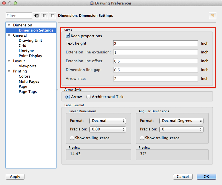

Please correct the text height to for example 2 (for 2 Inches):
Screen Shot 2014-03-17 at 23.07.31.png (102.08 KiB) Viewed 16575 times

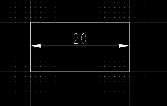

Your dimenions should then behave as expected again:
Screen Shot 2014-03-17 at 23.08.39.png (11.94 KiB) Viewed 16575 times

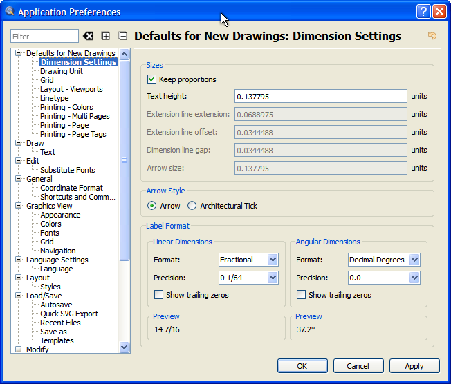

Double-check also the Defaults in "Application preferences" / "Defaults for new drawings" / "Dimension Settings". That is what QCAD will use first of all as defaults for a new drawing.
Here are my default settings for new drawings: I work most of the time in inch. The Text hight is 0.137795 what is equal to ~ 3.5 mm (Scale 1"=1").
