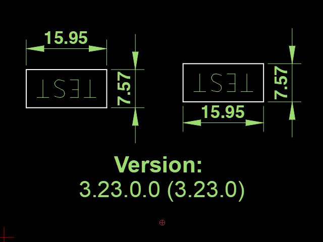

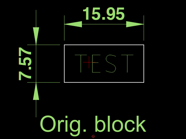

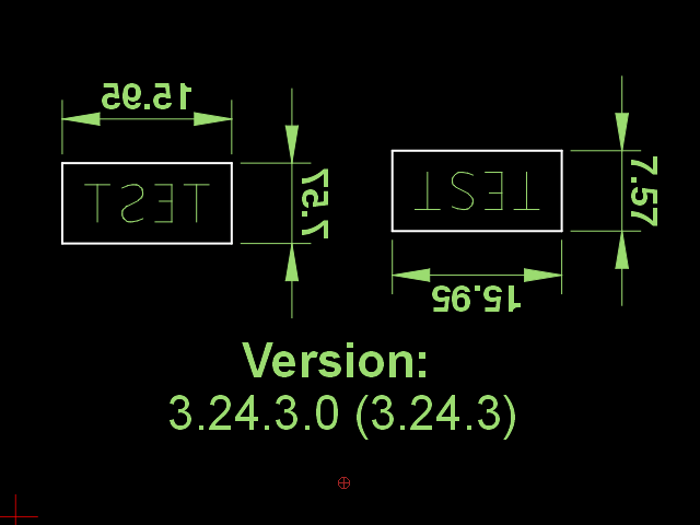

Orig. block
Same drawing loaded in different QCAD versions:
3.23.0.0
3.24.3
flipped block.dxf
(106.43 KiB) Downloaded 1238 times

Re: MIrror a block with text in it
Posted: Wed May 06, 2020 9:45 pm
QCAD 3.24.0 has introduced non-uniform scaling of blocks. The only way to achieve this was to change the way how block references are rendered. A block is essentially rendered through a transformation matrix (applying the rotation, scale and translation).
As you can probably imagine, it's hard that way to somehow exclude texts from the transformation or treat them in any way differently.
As it happens, Autocad (and other, compatible programs) have the same issue, probably for similar reasons.
Long story short: the new "bug" is actually a somewhat unfortunate bug fix, making QCAD >= 3.24.0 more compatible with other CAD systems. This change was not intended and creates indeed an inconsistency between QCAD < 3.24.0 and QCAD >= 3.24.0.
RaNoPlus: Perhaps, you might want to downgrade to QCAD 3.23 for the time being?
Husky: in a future version there might have to be a preference for this, letting you choose between the Autocad compatible mode with support for non-uniform scaling and the legacy QCAD 3.23 mode with special text treatment (strictly speaking wrong).
