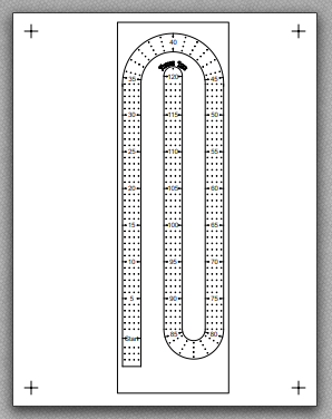

I have a drawing that spans 2 8.5 by 11 pages.
I am choosing to print crop marks. I see them on the display.
They do not show on the printout or a pdf.
I have tried printing pdf from qcad, the ms pdf printer, and my brother laser printer.
It looks like they are at the extreme corners of the paper on the display.
I have set a custom page size hoping to get the marks inside the printable area.
I am probably over looking something simple, I just cant seem to find how to get them to print.

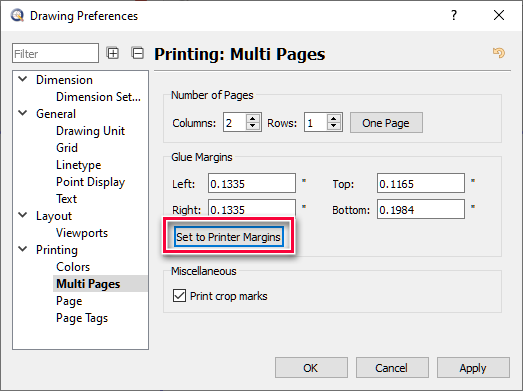

See:
Drawing Prefs / Printing / Multi Pages / Print crop marks
Re: crop marks
Posted: Thu Oct 08, 2020 2:22 pm
by fdixon
Thanks for the quick reply.
it is enabled (checked). I have tried turning it off and on again several times.
Did you try to "Set to Printer Margins" ?

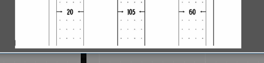

Printing from the model space I could see a tiny piece of only 2 crop marks, that is an improvement.
Each Layout Block can have its own printer margins, I didn't notice that before.
If I set the margins using the printer button I can almost see the crop marks.
That Is an improvement. But there is not enough of the mark to align with.
Is there anyway to adjust the position of the crop marks.
Adjusting the glue margins doesn't improve there visibility. To far in any direction and they just disappear.

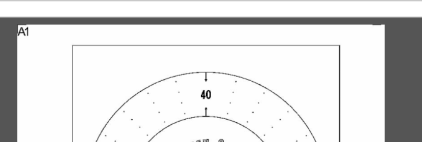

ahh, I didn't see the attachment area
qcad crop marks issue3.PNG (20.33 KiB) Viewed 19725 times
qcad crop marks issue2.PNG (26.52 KiB) Viewed 19725 times

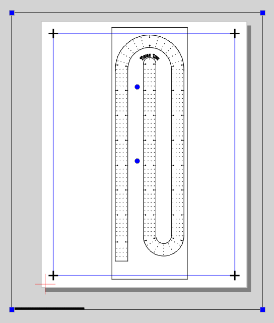

A QCAD issue .... :shock: I don't think that is intended behavior ....
In short:
printed a pdf with QCAD out of Model_Space - works,
printed a pdf out of Paper_Space - doesn't works,
checked the Viewports in Paper_Space - the crop marks are outside of the Viewports,
enlarged the Viewports to a size which will cover all crop-marks,
print to pdf .................. crop marks are included in the print!!!

The workaround right now would be to cover the crop mark positions with a Viewport.
I already filled a bug report below https://www.qcad.org/bugtracker/index.p ... &sort=desc

Printing to the Brother printer (not sure what happened when husky printed it) the crop marks barely print or did not print.
Printing to PDF the crops marks print if the viewport expands over the crop mark positions. OR If you add text or a dimension to the printable area in the paper space but only on the page covered. So if you have to pages add something to both pages to get the crop marks. I suspect anything added to the printable area will cause them to print but I haven't checked yet. I'm leaving this alone for a few days or a bit. I hope this will help anyone else that runs into this. I will check back later.
