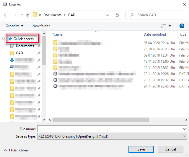

Unfortunately the current QCAD version does not support this option what means the "Save As" folder is controlled by Windows.
Maybe it helps a bit to set a "Quick access" for the most needed folders in Windows. Just navigate to the folder, right mouse click on it, chose "Pin to Quick access" and it will be listed on the left side in your "Windows Explorer". You can then move it (up - down) with the left mouse to what ever order works best for you ...
