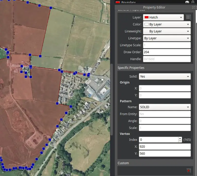

I'm trying to add opacity to a solid hatch fill but there doesn't seem to be Alpha input on the Specific Properties in Property Editor.
Has it been moved elsewhere?
thank you, Jake
QCAD Pro 3.23.0.0 on Linux Mint 22.1 (Ubuntu Noble)
- Posts: 4874
Re: Opaque Fill not available (v3.23.0)
Please consult the QCAD Changeloggrowdigital wrote: ↑Tue Jul 01, 2025 7:43 pmI'm trying to add opacity to a solid hatch fill but there doesn't seem to be Alpha input on the Specific Properties in Property Editor.
The Alpha channel for Hatch entities was introduced for QCAD v3.26.0 (2021/03/02)
QCAD v3.23.0 was released on 2019/07/19
You need to update your 6 year old installation.
