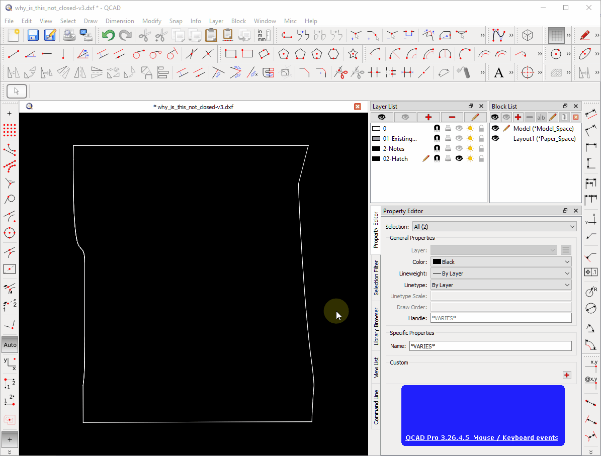

Like In this attached example, I broke out my problem area out of a huge set of site plans, its the typical hatch that trips me up.
This one keeps getting open points everywhere, yet it all seems connected.
I turn off the 'hatch' layer before trying to add the new hatch but to no avail I get loop not closed.

This is what I call a 'problematic bulging polyline' lately.
Presumably originated from a spline.
I am looking into a method to round any given polyline at its corners and face the same issues.
What happens is that QCAD decompose your polyline into arc segments.
At a certain point that can't be done mathematically correct and is leading to minute gaps.
That may occur more the smaller the bulge factor is e.g. 0.001527 and is exponentially.
One can see that zooming in at two things:
- Midpoint markers of bulging segments seems to be off.
- The selected segments for hatching seems to be aside the original polyline.
Selecting segments for your boundary is also problematic there:
- It stops at an intersection with the crossing lines and leaders.
Cutting the already troublesome segments at that point.
- It stops were the pattern of the upper AR-CONC pattern touches the horizontal polyline segment.
What is considered as being buggy.
Such positions where already no longer regarded as snappoints.
*EDIT* Filed FS#2264: https://www.ribbonsoft.com/bugtracker/i ... sk_id=2264
Best way is to duplicate the surrounding shapes and to create a single closed contour.
I do this by default and keep them on a dedicated layer. :wink:
Added layers '_Boundary' & '_Hatch', the one holds a closed boundary, the other a solid hatch.
You can change the solid hatch into something else with the Property Editor.

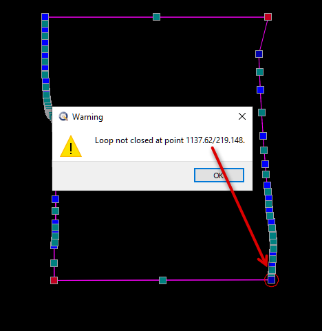

Update so I removed more stuff to make a really simple test file.
And I moved the outline of the area I want to make the hatch in to a layer called 02-Hatch
Now I turn off all the other layers
select the outline and choose 'draw hatch from selection.
I now get Loop not closed at point '1137.62/219.148.' instead of a hatch
When drawing a line from two points I enter '1137.62, 219.148' as the starting point I can see thats the bottom right corner
And I am not sure how to check the coordinates of the two intersecting points but if a zoom really far in
they stay connected.

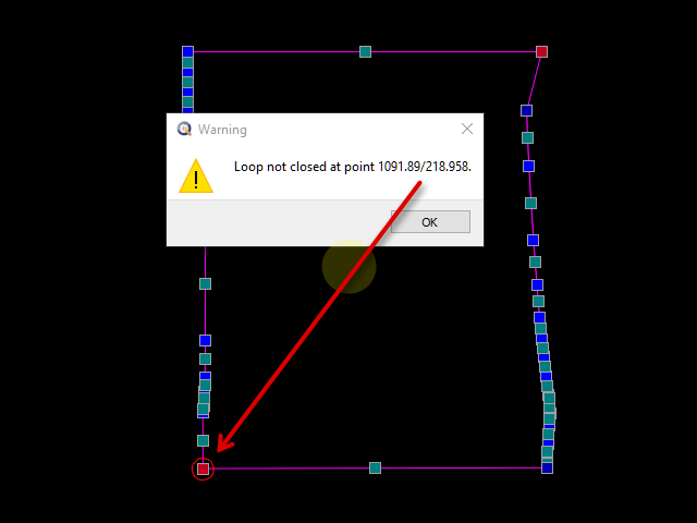

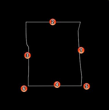

Note: Behind an "Automated Hatch" from selection is a very complex calculation what means QCAD needs a very clean contour to accomplish this task without any problems.
This said ... your example contour (why_is_this_not_closed-v3.dxf) isn't clean enough. The issue with that shape is that entity 2,3 and 4 is a duplicate. Additional an open contour at point 5 and an overshoot at point 6.
How did I find issue 5 and 6? If you get the message from the hatch tool that a Loop isn't closed it will also put a small circle at that point. Unfortunately - if you confirm the warning with OK and move the mouse pointer this circle will disappear.
Pay attention to those circles and check what could be wrong at that point!
If you fix those issues like me a hatch is easily created by QCAD:
