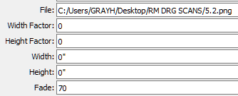

Graham wrote:
Mon Feb 20, 2023 4:37 pm
I have read up and have tried the property editor but you cannot select something that is not there.
Try:
Activate the Selection Filter (GF).
Entity type: Image.
Then hit the button 'Replace current Selection'.
This will select all bitmap images.
Because QCAD can not locate them the size will be zero.
All four corners their reference points will be at the insertion point.
Now only select one of those selected in group.
The expected path should then be displayed in the Property Editor.

I don't know why but something makes no sense at all regarding the images scales.
The images are there but not one image has a width more than 1.0e-323 (as Scientific Notation). That is 0.00000000000000000000000000000000000000000000000000000000000000000000000000000000000000000000000000000000000000000000000000000000000000000000000000000000000000000000000000000000000000000000000000000000000000000000000000000000000000000000000000000000000000000000000000000000000000000000000000000000000000000000000000000000001units. e_surprised e_surprised e_surprised
Try this approach with the provided example drawing:
make sure the bitmaps are still in the correct folder (C:/Users/GRAYH/Desktop/RM DRG SCANS), (C:/Users/GRAYH/Desktop/RANSOME & MARLES/),
load the dxf file,
use the selection filter to find and select all images,
use the Property Editor to change the setting for "Width and Height Factor from *VARIES* to 1,
I expect that the images will show up again but most likely all your scale settings are lost and have to be redone.

Mon Feb 20, 2023 11:46 pm
There is definitely something wrong with the scale factors in the provided file.
Another question would be why they are all inserted at position (0,0). :?
But maybe these are just artifacts.
Given Huskey's example but literal from the dxf:
The file C:/Users/GRAYH/Desktop/RM DRG SCANS/5.2.png
- Is inserted at (1700, 2338)
- Pixel scales are twice 0.000588235294117647
So these values are not stored as zeros or as almost nothing.
Graham wrote:
Mon Feb 20, 2023 9:27 pm
I presume you cannot see the images without the appropriate files?
Indeed. Even the path C:/Users/GRAYH/Desktop/ doesn't exist here for obvious reasons.
QCAD can't retrieve size information but then again any size times nothing or almost nothing would always be nothing.
