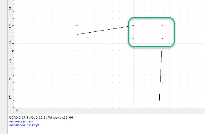

I don't get an error so i suppose it works somehow, but the spline does not get drawn. Is there anything else to be done?
The spline should show up inside the green rectangle.
I attach my full script just in case. Adding lines and points works like a charm.
Best thanks and regards
Irene
Many thanks for the quick reply

The spline degree is 3 (cubic) by default which means the spline needs at least 4 control points. You can add another control point or change the degree to quadratic using setDegree:
var sp = new RSpline();
sp.setPeriodic(false);
sp.setDegree(2);
sp.appendControlPoint(new RVector(138, 81.44444));
sp.appendControlPoint(new RVector(129.83333, 81.44444));
sp.appendControlPoint(new RVector(129.83333, 85));
addShape(sp);-

Hello Andrew,
Works like a charm, thank you very much
