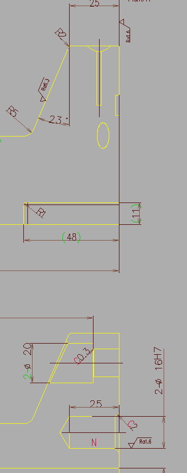

First is angle and hole dimension.
File 0030.dwg

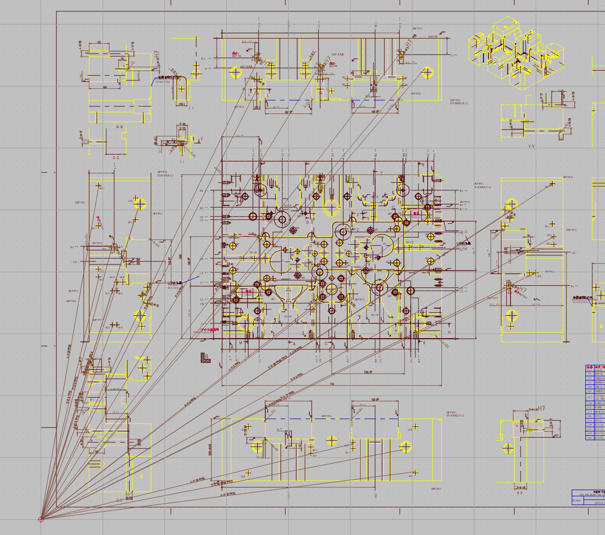

And second is too much diameter dimensions from zero coords.
File 0002.dwg

The dimensions in this file are stored with invalid / wrong coordinates.
The way this works is as follows:
- Each dimension is stored with various reference points that define from where to where the dimension measures, where the dimension line is placed, etc.
- Each dimension is also stored with a dimension block which contains the visual representation of the dimension (lines, arrows, etc.) as a type of cache.
- Usually, these two sets of information correspond with each other - in these two drawings they don't.
- Other CAD applications might simply show the cached dimension block, regardless of the reference points stored in the file. Note that if you modify such a dimension ever so slightly in another CAD application (e.g. by moving a reference point slightly), the dimension will be re-rendered and will look as shown in QCAD.
- QCAD always renders dimensions from their reference points. Dimension block caches are ignored.
You can force QCAD to use these dimension block caches using the command line switch -recompute-dim. This is only recommended if you only want to export or print a file "as is").

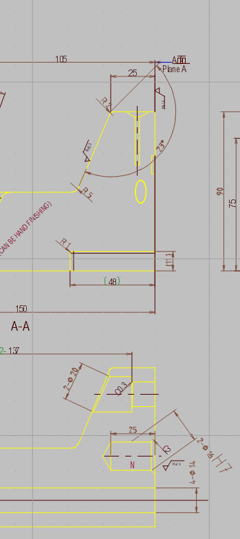

Post by martblek » Wed Sep 02, 2020 9:24 am
Ok.
Thank you for answer.
With this option working perfectly.

Post by martblek » Fri Sep 04, 2020 11:06 am
Hello ,
like i said, with this option "-recompute-dim" importing work ok.
I tried to export as SVG, there is no problem with result
But if i want to export as PDF i must change paper size and then these dimension lines are back :(
