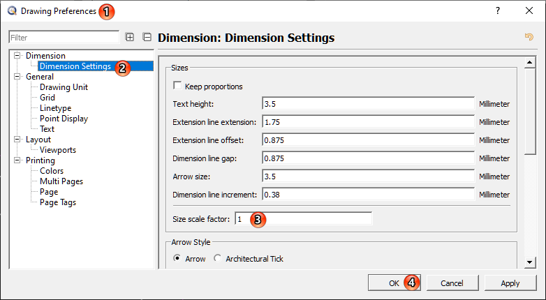

In Drawing Preferences / Dimension settings is a scale option which works for Model_Space and Paper_Space.

My suggestion works also in the aftermath.
